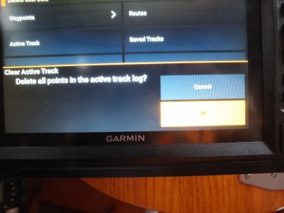

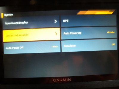

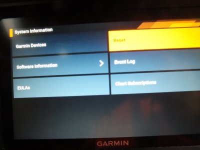

I discovered how to clear the tracks as follows...............

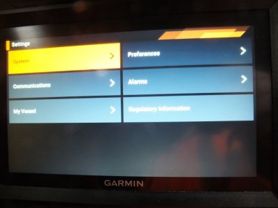

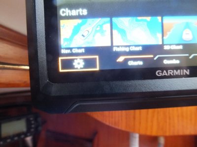

Go to the Home screen and highlight the ships wheel - botton left of screen - select.
Highlight System - select
Highlight System Information - select

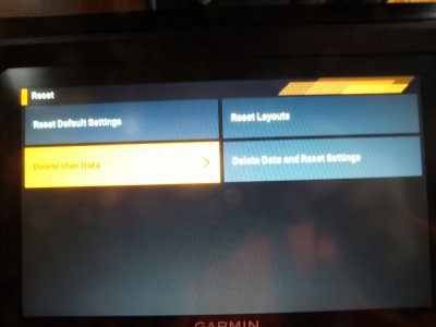

Highlight Reset - select

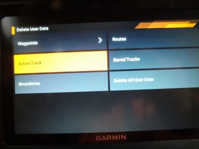

Highlight Delete User Data - select
6 options now appear
Waypoints/Routes/Active Tracks/Saved Tracks/Boundaries/Delete All User Data
Just select which one you want to delete and do the deed.

Thanks Paul for your kind offer., I will turn my attention to updating the software in due course and let you know how I get on. The software version is pretty ancient as far as I can see, it is version 28.10.

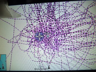

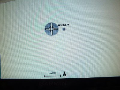

As I have just learned to resize photos and as a photo tells 1000 words I will post below a bunch of photos I took yesterday of the steps indicated above.

Angly is the name given to me of a wreck off Whitby - no idea what its proper name is but I catch a Cod or two there. Will be having Cod and Chips today using the Cod caught off this very wreck.
