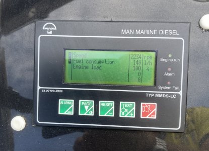

My MAN engine filters ( two on each engine ) are 2 microns and the racor pre filters 20 s .
This boats rated WOT is 2150 so we are 80 over a tiny under 1% which is correct .
2003 engines with a 1000 + hrs done Sept after a June haul out 2023 so twenty yrs old .
Yes the boats got “ cruising stores “ etc etc
