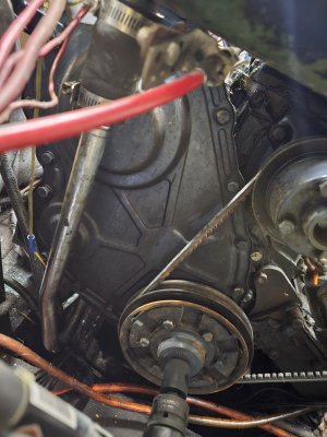

Okay, so some success, I found out that Dolphin build engines with a "standard kit of Bowman parts" and I have the lake water cooled exhaust (which I knew, I had a wet exhaust, but apparently I should always mention that when dealing with parts).
