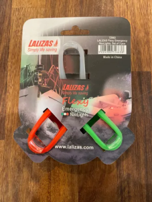

Anyone used these?
My lights have been playing up, for some unspecified reason, so it might be wise to get a set - are they any good? What batteries do they take?
Thanks.

Cannot comment on how good they are but they would not be anywhere near the top of my shopping list
They take CR 2032 batteries according to Seamark Nunn

I can't see exactly from the pic, but if they're the ones I'm thinking of then the exact same thing used to be available in red and white for ~£5 a pair from the bicycle section of Decathlon:
Video: Clover 1sets Free Sample Cheap 2 Led Colorful Bicycle Rear Lamp Safety Waterproof Rubber Silicone Bike Light - Buy Silicone Bicycle Light,Silicone Bike Light,Bike Light Silicone Product on Alibaba.com
Ok for an emergency, I'd guess. Can't be worse than those old style emergency nav lights (Plastimo?) that were really no more than a housing for an incandescent bulb and a type-C torch battery. Anyone else have to fix those with little balls of rolled up kitchen foil because the battery holder was so rubbish?

Yes, I've used them (or rather just the green one when the LED failed inside a two year old Jeanneau nav light).
They are cheap and nasty, more like a child's toy watch. The battery mount is not secure nor waterproof. I think it lasted about two hours by which time somebody hoisted a big shiny thing in the sky.
As Monty suggests, put the money towards fixing the problem.
