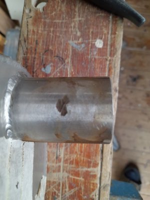

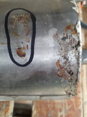

Tranona - The halyard link was good, they have so good cylindrical waterlocks at a reasonable price but none quite small enough in diameter to enable me to achieve an acceptable drop from the engine. The also do "cuffed" exhaust hose, anyone tried it?
Vyv - The corrosion is very limited, there is a small pitted area in the inlet and and outlet pipe. There are a couple of patches of more general corrosion on the base of the cylinder one patch near the end plate weld and the very slight pinholes in the area ringed on the photo. Two photos attached, how it works

Your photos suggest the pitting is on the outside of the trap, in one case beneath the hose. Is this correct?
davidmh
30 Jan 2015
436
Vyv - yes beneath the hose. the other areas are on the outside of the case, it is clamped to to stainless shoe which does make contact with the area of the corrosion, there is no leak from this area. The area circled looks different it is very small pin holes and a slight discoloration almost as if the corrosion on the inside is about to break through, this is where the leak is.

Definitely not electrolytic, looks nothing like it. It seems to be crevice corrosion due to water between the trap and hose/bracket/support. The hose one is easy, use some sealant. This may arrest the leak that is causing the rest.
I had a central heating tank that failed like this. Corroded through from outside where the tank was in contact with its stand, rainwater accumulation.
