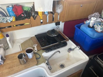

We use a single portable induction hob placed on top of our origo alcohol stove retained for a backup along with 5 litres of meths and now not used for 3 years.

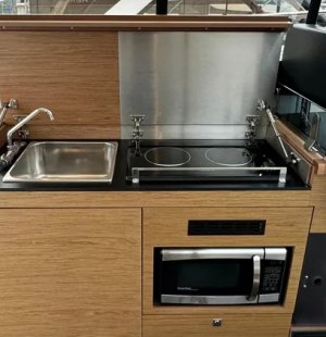

Quite a coincidence this post as the boat I viewed this afternoon was the only one I've seen that has electric cooking - an induction hob and a microwave, rather than gas and, I must admit, it appeals.
It's also the only NC11 I've seen that has a generator and an extra battery. It may have a larger inverter as well but I couldn't find a schematic in the manual so the broker is going to ask the owner.
I think I'd like to replace the microwave with a combi if I can find one that fits ( assuming I buy it!)IMG_4573.jpg
