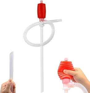

Is that with a 20 litre can?
Edit....just googled it. Interesting!
I've been using a jiggle syphon to empty 20l sceptre cans quite a bit this summer. Once to move 8 cans worth into a motorboat (when all the drystackers had dumped their toys on the fuel pontoon so no one could access it!) and once to refuel a tractor with 4 x cans. They are about the cleanest way I've ever transferred diesel. Just keep an eye on the tube and tilt the can so the end of the tube gets the last of the diesel. Empty the syphon properly and it just needs a wipe with a cloth/spill wipe. They are not the fastest way, and slow down as the can empties but a small price to pay for clean decks.(y)(y)(y)
