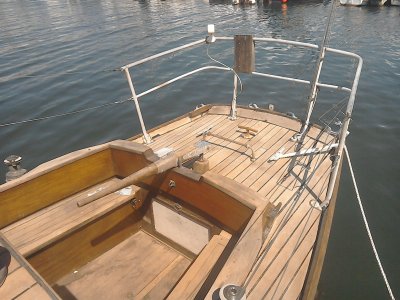

That is why a cockpit cover pays off. A typical pleasure boat is in use underway for somewhere between zero and maybe 10% of its life during which the crew can deal with any water that comes aboard. Of course you can fit an automatic bilge pump for when the boat is unattended, but much better to stop the water from getting on board in the first place. Another side benefit is that the woodwork stays pristine. Phot shows the cockpit of my Eventide over 20 years after the teak was laid and the varnish applied.
The boat I referred to certainly had covers. A fitted cockpit over, which really kept the rain out, and an over boom cover for the sun protection. Plus a winter cover that was too hard to remove to be fitted after every sail.
The owner was convinced that boats like thst are better in every way than their modern counterparts. That it was intrinsically more seaworthy, and more comfortable. I begged to differ, though I’ll sail anything. It was hideously wet, an order of magnitude worse than a Dragonfly.
