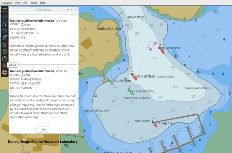

According to Chart 5011 there should be the word 'moorings' associated with such an area. I am using OpenCPN and o-charts and looked at the texts (right click) but didn't see that 'Numerous moorings ...' Where is that to be found? I notice the dotted line goes through the marina pontoon.

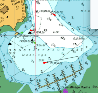

The UKHO raster chart 2388 for Dunstaffnage Bay to Connel Bridge also has the dotted lines around the pier area, black in this case. But it also has text saying Moorings outside the dotted box - not shown on your O-Chart.
As noted above, a dotted line simply shows a boundary to an area. The area can be many things. The UKHO raster chart version I am using has an issue with sometimes losing Notes, so perhaps there is a note on the original chart to explain.

......... I am using OpenCPN and o-charts and looked at the texts (right click) but didn't see that 'Numerous moorings ...' Where is that to be found?
I use o-charts too. The pink (to my eyes) broken line that you are seeing is only shown when I select "Show ENC Anchoring Info".
You've already right-clicked on the chart (post #4) to do an Object Query but to see the "Numerous moorings" text you need to scroll down that text box. Interestingly pretty much anywhere I right-click on that chart I get the same message, even on land. I looks like a general warning rather that something which is restricted to the area bounded by the pink broken line.

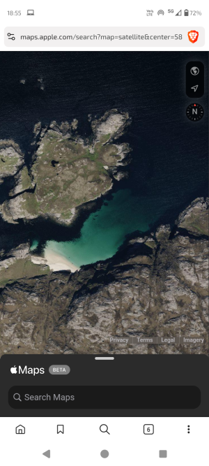

Another point about these charts. The old bw ones had much more information on the nature of the seabed. The current ones (even Antares) have much less detail, if any at all. How are you supposed to choose a spot to anchor from a chart if you don't know whether it is sand or rocks? At least Navily and suchlike have some indication.
Google maps or better still Apple maps aerial view. You can often see clean and sandy seabed in water where there's still 3 metres at low water.

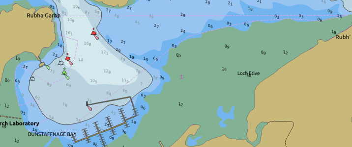

The o-charts do have some information on the nature of the sea bed as you can see from the picture in post #9.
As does the UKHO raster chart shown in post #5. Basically from the same source.
