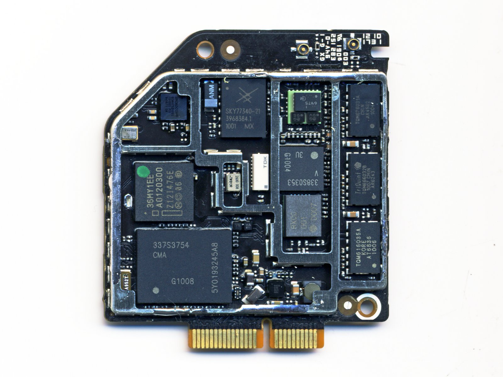

Does the iPad 2 3g have GPS standalone. YES or NO?

When you call ask what the Broadcom BCM4750 chip does. It's the chip in the top left corner:

This is complete nonsense.
The ipad2 with wifi and 3g has the broadcom BCM4750 chip. The picture I posted above is from an iPad 2.

I don't need to call Apple. I have talked to Broadcom. They make the chip. It is a 24channel gps with some functions passed onto the host chips to keep it as small and fast as possible. The Assistance is used to speed up SV acquisition and TTFF when the almanac data is old and to correct multi-path propagation. It will work with no wifi or cell data as a standalone receiver.
Great answer: the one I was after thanks! It has GPS! The kind my Garmin Geko has but better.
Look chaps I only wanted to believe beyond all reasonable doubt that iPad 2 3G can be used as a life saving device at sea or in the remoteness of non cellular areas.
Cheers for all the replies: delivery is due next week some time.
