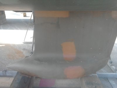

Get a repair kit from AMC to do the patches. Looks a bit messy when you do it, but soon blends in when the boat goes back in the water. Photo shows patches on the keel of by Bavaria
