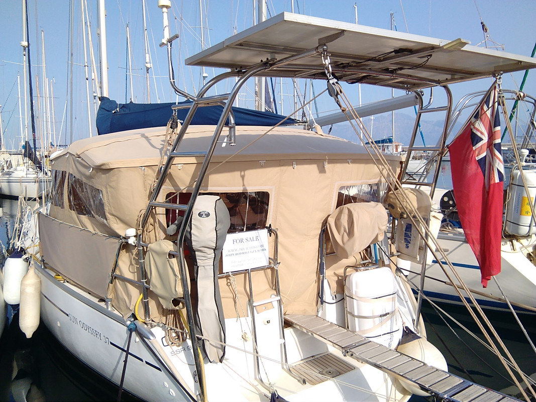

Yes, we went for gantry for solar and dinghy. We don't leave the engine on when hoisted underway though unless flat calm.

Most davit/dinghy combinations allow the dinghy to be hoisted up tight so it doesn't move whereas hanging from a gantry, it will pendulum. Ours, hanging from gantry weighs a little over 100kg with engine mounted so needs less cross bracing (springs) with the 27kg engine off, which only takes a couple of minutes with lifting arm. We only take the engine off when actually sailing which is far less than the time spent on mooring or anchor with the dinghy in daily use. It gets hauled with engine at night.
