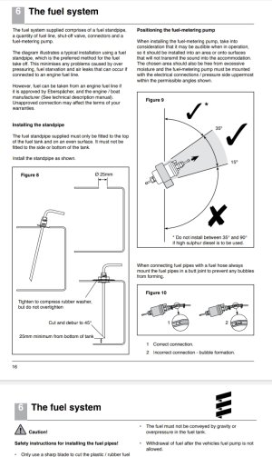

I asked Owen (tech director of Autoterm) He says all the branded heaters use the slope of around 15-30 degrees except a special Webasto one. The slope ensures no air and is quieter. The horizontal info from a dealer is incorrect as there is a spring return. Important that the hose continues to run uphill to the heater.

We were talking about the fuel pump rather than the heater. Usually the pipes are at the bottom on the heater itself, although no idea whether it makes a difference
So is it supposed to be 30 or whatever degrees from the vertical or the horizontal? Any instructions that just say 30° is meaningless.
