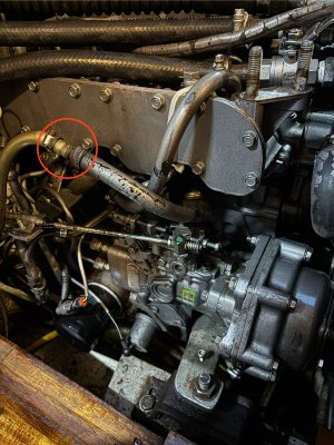

I believe your engine fuel filter has a hand priming pump on the top of it. If the primer is sucked down when engine is running you have a fuel blockage before it. Not sure where you fed the injection pump but if you feed the injection pump directly from a clean container with the return going back into the container and you still have the symptoms after running for a few minutes then the fault is within the injection pump, probably the vanes of the lift pump being seized.
I have connected the electric pump here, but there is another 15-20cm of the hose left, that might be sucking air. On the other hand, I did not see any bubles in the return line…

An electric lift pump is used on direct injection engines as well. I know it’s not common rail. The system on yours looks quite grotty and those hose clip connections don’t fill me with confidence. Take the manual lift pump out of the system/equation and replace it with the electric pump to experiment whether it solves the problem. If it does then you know the lift pump is bad. If it doesn’t then you have a blockage on the suction side. Bug/black sludge hits the suction stack pipe in the tank first so that’s where blockages start.

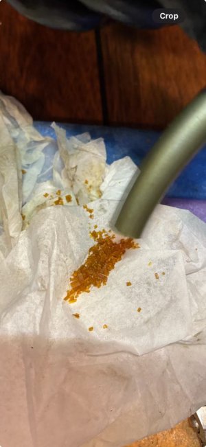

Small update…
Now the question is if some of that shit os also in the pump/injectors.
Will clean it all and see.

Looks like brown sugar :oops: Did you taste it (tip of tongue)?
What part of the fuel line did you find it in?
Your filter should have catched it.
That is the “funny” part - it is just past filters in the lowest point of the fuel line. The water separator is built in the filters. But this hose was lower than that. Probably in the 2-3 years the boat was standing in a garage - that what was the result. There is no secondary filter (that I can see) before the pump. I will install one as I am all in diesel anyways…
