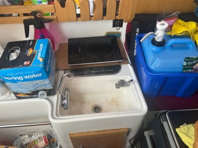

Perhaps we are well over the top but we are very sensitive to drinking water quality.
We have plumbed pressure sea/lake water to the sink (and anchor chain wash tap and one of two stern showers/hoses) plastic fitted tanks water hot and cold taps to sink, internal and stern showers, hand basin and 15litres hand pumped food grade portable container overhanging the sink and spring water with tap on the other side of the sink.
As we have to collect fresh water from uncertain natural locations when very remote inshore cruising it made sense to separate water quality types.
We have 60 litres of those plastic carrying containers for collecting quality drinking water from distant locations by dingy.
140 litres of fitted freshwater tanks which may be filled by hose from waterfalls and the like and generally carry around 50litres of shop purchased spring water.
This is all on a 28 foot trailerable yacht fitted out for long expedition cruising to very remote locations.
