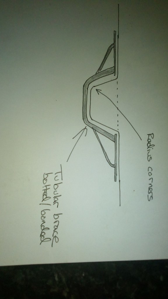

The only way I'd consider that is that the piece you cut out, would effectively hinge down and when access had been gained it locks back in place and basically becomes structural again. Oh, and waterproof too, as you are seriously lowering your freeboard. All of which would be very difficult and costly to engineer. Not impossible...airliners have doors in them...but this will be tricky.
I suspect your insurance company would want nothing to do with you either!
