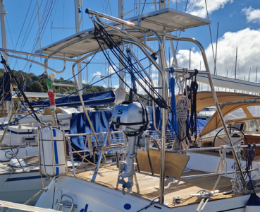

This is the pic of the solar arch I designed for my boat.
It includes
Mounting for life rings
mounting for dan buoys
mounting for TV arial
mounting for Radar
mounting for wind generator since removed.
mounting for ladder on the stern to gaining access.
Connection for cockpit cover.
VHF aerials for radio and AIS.
Spotlights to light up cockpit.
Mounting for trucking under arch doe access to wiring.
Mounting for electronic compas for autopilot.
Davits for lifting boat and or outboard engine as backup.
Stabilizing attachment to Pushpit.
outboard bracket on Pushpit and engine hoist on port side.
