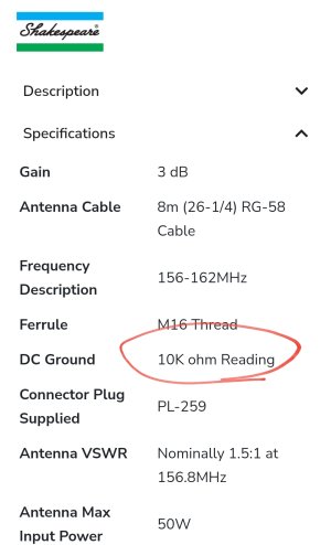

A dc resistance measurement isn't a huge amount of use on a VHF antenna that's likely to have a base load (coil) at the bottom.
Some of the V-Tronix marine antennas will for example measure 10kΩ between centre and outer (and this is detailed in their instructions).
Best connect up and maybe borrow a power/SWR meter, although bear in mind that if the antenna is parallel and close to the ground, you might not get the same measurement as if it were in clear space when vertical (but better than teat).
10kΩ could look like short circuit on your meter so maybe about right though.
