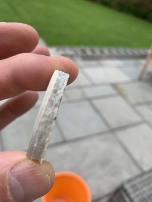

On the subject of gelcoat thickness. I cut a section from the boat to send away for colour matching. I was staggered by the thickness of the gelcoat.

On a 1975 boat the one thing you can be sure of is that that won't be consistent across the moulding. It's likely that it'll be thicker than recommended all over due to the relatively basic application methods used, but there's no guarantee you won't have a thin spot
