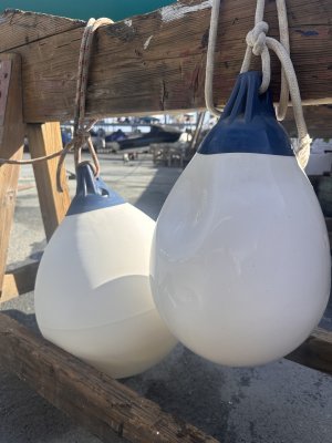

what is the best way of cleaning / restoring fenders?
I don’t believe that it’s possible to clean / restore a dirty (white) fender.
I take pride in keeping my boat clean but measured by my personal level of satisfaction, my fenders are dreadful.
There’s nothing on the Periodic Table of the Elements that I haven’t tried at one time or another.
Cleaning them as soon as they are marked or as a job on the list in preparation for launch, nothing works; Fairy Liquid, Jif, Acetone, Solutions with marine tax or Screwfix No Nonsense etc etc.
This topic is often raised and if ever there is a suggested alchemy that I’ve yet to try, I usually buy it. Much to my chagrin, I’ve yet to find anything that makes the slightest improvement to a grubby fender.

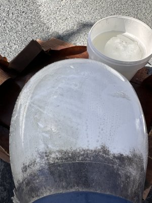

Having scrubbed off the adherent green growth with detergent and allowed to dry, this stuff does a good job on engrained grime, such as the Hamble gets from Fawley refinery, see Everbuild PVCu Solvent Cleaner
Just ordered some to try.
I've found other the years other cleaners struggle with the engrained grime and was getting to the stage of purchasing new fenders.

I have good results with using vistal.
