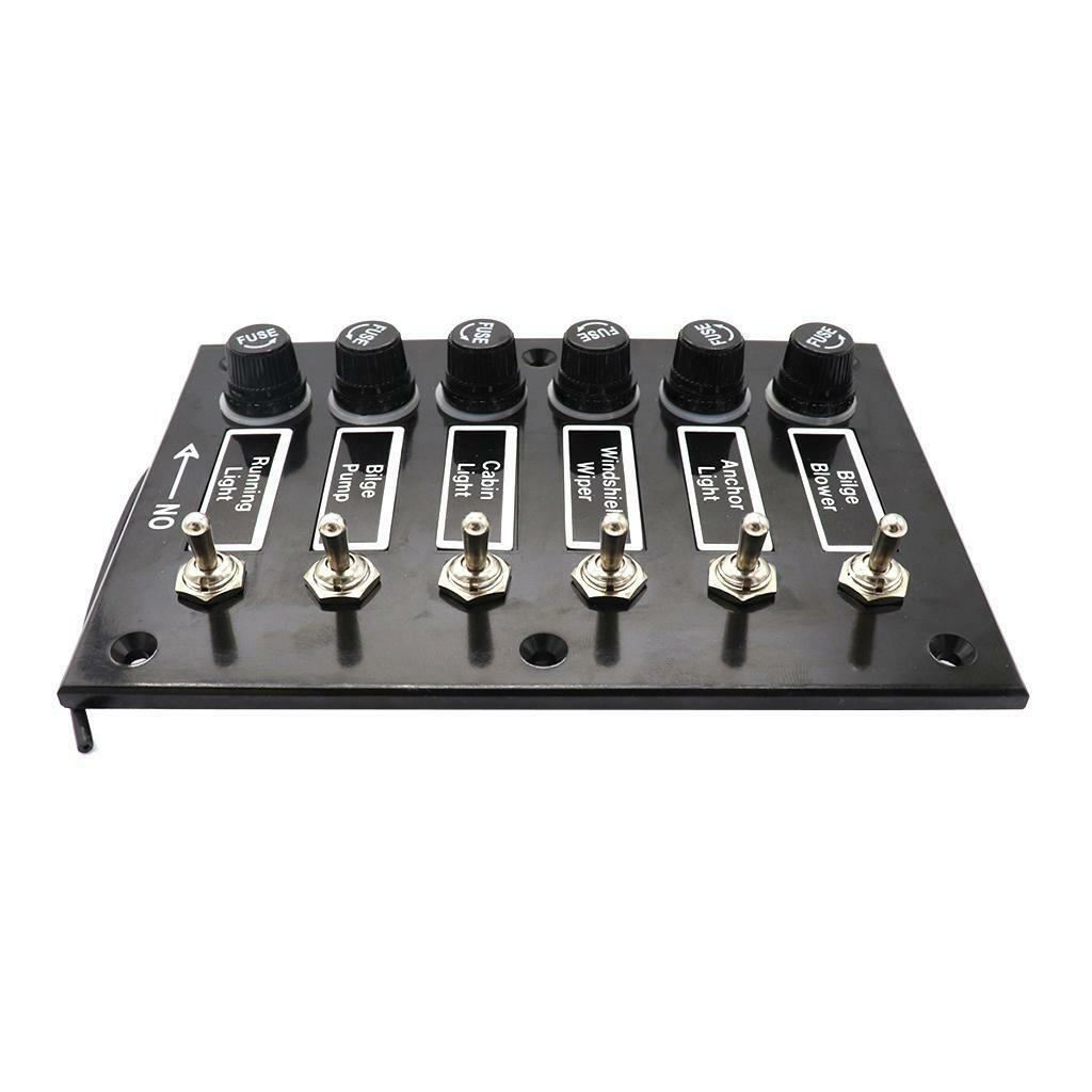

Chinese switches and panels on Ebay and the likes are usually poor quality. There are some exceptions, but finding them can be tricky.
Quality switches/breakers from the likes of Carling, ETA etc will virtually last a lifetime.

That was the attraction of using Axon. The switches are Carling and all wired to a single input. In terms of price, the 16 way panel was around £120. The cheap Chinese panels as in post#12 are usually 6 way and cost £30 or so each on UK. Better 6 way panels like Blue Sea are around £60 each.
If you went for quality all the time even when the fuse/switch/circuit breaker/ light bulb is non critical you'd quickly go broke.
The knack is to achieve the balance of price/quality that suits you. I find those Chinese switch panels clunky and ugly - but that is perhaps because the last time I did a rewire I had a custom made panel from the company that made the panels for lifeboats and the admiralty small boats. A work of art but expensive at £500 25 years ago.
With my latest project I would have liked to replicate that but the firm is long gone and the estimates I got from another firm were more than I could justify. So my use of a ready made panel with good quality components for a relatively small premium over the Chines ones was a good compromise
