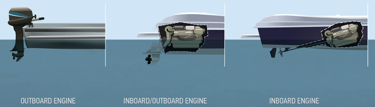

History has it that outdrives in general and B30's in particular means a lot of hard earned used to pay for experiences that you'd rather be without.
Conversion to shafts isn't straightforward but if your planned/intended use allows, a bracket and outboard(s) is an easier & faster way to go.
Do a full and comprehensive budget before you even start - without optimistic assumptions.
Boaty things are complex and expensive.

Twin engines + tubes & shafts + gearboxes + reinforcement of hull + brackets + rudders/hydraulics + rebuild of engine bay/mounts + cables and more. A lot to spend time on ;)
It's an exciting project, hard to judge if the budget is sufficient without knowing the boat and your expectations for the result. Or your schedule.
Pictures would be great.
31' Semi-planing and with 2x170 hp sounds a bit unusual. How do you intend to use the boat?
Volvo's B30 was made from 1968 to 1975 (a fairly short production run) and was basically a cast iron 4-cylinder B20 with two extra cylinders. Made in 117-175 hp versions, the marine version was marketed by Penta with 3 downdraft carburettors and a hotter camshaft to make 170 flywheel hp. Known to consume a lot of fuel.
Not many were fresh water cooled and most have long since rusted away.
Modern 4-strokes are in many ways better (and use far less petrol) than old car engines that were marinised, and spare parts for marine B30s are difficult or impossible to find.
I wouldn't rule out outboards completely. They are complete units with engine, gearbox, shaft, propellers, steering and all. Good access to service and maintenance and easy to replace should the need arise.
In addition, they solve the safety issue when petrol engines are in a closed space inside the boat.

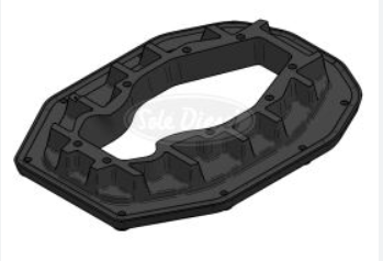

Great to hear that you are doing the job just because you want to! I've done that all through my boating "career". Personally I would keep looking for drives as this will be a much easier project. Don't fixate on any particular make or model, just find a pair that will do the job. Don't involve professional outsiders in the project as that will make it too costly. Everything you need to know/learn is available in books and on You-Tube which is a fantastic resource in finding out how to do things! You will have a comprehensive set of 'experts' here with varying degrees of expertise, just sort out the wheat from the chaff! As a new member you will probably not be able to post pics until you have made a few posts. Once you can get some pictures up the advice will be more targeted and accurate. If you are a practical type you will love this project. By the way the most important rule of boat rebuilding is to never buy equipment from a boat shop. Always find your local specialist supplier. Hydraulics, stainless steel nuts and bolts, fibreglass, timber, plumbing, electrics, etc. etc.
Since Volvo drives have been removed the cut-out in the stern it will fit the same.
Merc drives will need a transom adaptor plate as their cut-out is way smaller

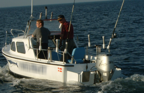

lots of this about on youtube, the pod can be made big enough to provide xtra floation aft if needed
Did that once when making a trolling boat out of a 15' hardtop. Added 2' to the length (much needed space inside) and 240 liters/kg buoyancy while carrying a Honda 35. The "bracket" was made of aluminium.
That is an intriguing idea and one which I had dismissed as I wasn't sure about the stress on the transom and the mounting points, I might revisit this with a marine architect to take account of the stress involved; power outputs / sea states etc.
