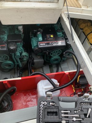

Hi !
my kad44 run on plane a touch north of 90 deg c , the port ( connected to the water heater ) ~91 , the stb ~93 . No overheat alarms and no issues but still a bit to warm for comfort imho . Reducing to hull speeds temps drop quickly to ~82
The impellers came new last spring but i guess the heat exchangers were never flushed .
Some questions :
I want to ir gun the tstat housing to verify the temps . Some questions
-Is the ir gun pointing at the housing accurate enough ?
- can the heat exchngers be flushed on the water ?
-only the very expensive rydlyme or can or are there other good desclers on the market ?
Thanks for hints

Engine can be flushed with the boat afloat. Disconnect the intake hose, after the pump, and connect it to a pond pump (or similar) output. Disconnect the hose that goes to the exhaust elbow and fit a hose that goes to a container of Rydlyme or similar. Put the pond pump in the container, just off the bottom. Turn the pump on and it will circulate the Rydlyme around and around the engine. Leave for a couple of hours, reconnect hoses and run the engine for a while.
The above may differ slightly with the connections on some engines/transmissions.

No need to drain anything. Normal flow has always worked for me.
You can't damage any gaskets if you don't pull anything apart, which there should be no need for if you are flushing as above.
