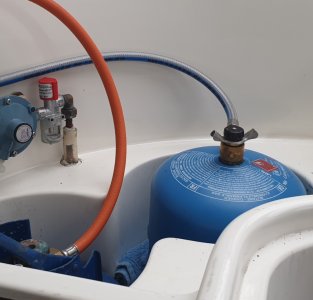

Someone pointed out recently that when the hose leaks on those the leak is high pressure and unregulated so theoretically less safe than on bottle regulators for a boat. Not a huge worry, but something I’d never considered.
Although it's the same that way as with any other bulkhead mounted regulator. They're used in boats and caravans the world over.
If leaks were commonplace then I'm sure bulkhead mounted regulators would have been banned by now.
If a poor quality bottle mounted regulator fails then you could get full pressure gas through the low pressure hose.. not sure either is worse than the other..
VicS
13 Jul 2002
48,536
My solution to changing a Camping Gaz cylinder without this spinning the bottle nonsense is to have the (lp) hose securd to the regulator with a clamp which can be undone without tools. I can then easily detach the hose , lift cylinder c/w regulator from the locker, transfer the regulator to the new cylinder, re-install in the locker and finally refit the hose
