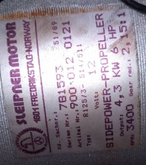

My bowthruster has a 4.3kw motor. My understanding is that at around 12 v this would require a supply of something like 360 amps.
It is fused with what appears to be a 200amp fuse. I understand it was working fine in the past with this setup.
Am I missing something?

What make/model of thruster ?
200A seems a bit low if it's a 12V system, sure it's not 24V ?
Definitely it's a 12v system.
It's a Sleipner/ Sidepower thruster from about 1989. I have never heard it run as I disconnected all the heavy cabling that I couldn't identify or or need before I moved the boat...( It was a huge mess)
It's only recently that I took out that fuse to get a better look and was surprised to see that it is only 200a it's a seriously beefy yoke with a holder to match...along with plenty of exposed metal.
I'll be moving it or at least putting it into an enclosure. Probably I should pick up a spare or maybe a slightly stronger one if the holder is the same.

What's the make/model of thruster ?

The fuse is way under rated, i'm surprised it works at all. Sleipner specify that the current 4.4kw thruster should have a 400A ANL fuse. Maybe a change would be better ?
For instance; 200A/300A/400A ANL Fuse Set w/ Fuse
Covers are available for the current NH! fuse ; Mersen L201881 MERSEN (FERRAZ) NH-1 TERMINAL SHIELD | Kempston Controls but the ANL looks a better choice.
