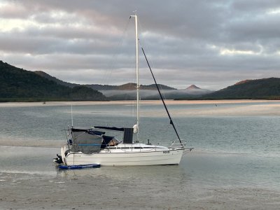

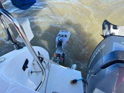

Forget the green bit (which is still very debatable over whole of life cycle costings) what I love about electric propulsion is the quiet!
We use a torqeedo 1103 to power a 3.5 ton trailerable yacht when needing to move in low wind and or on the nose cruising.
River cruising is particularly pleasant under sail but bends changing the wind direction are then easily dealt with by a quiet push under our torqeedo outboard.
Recently we quietly powered for over one and a half hours at about 3 knots directly into a 5-8 knot breeze in complete tranquility watching the extensive bird life which was undisturbed by noisy engines. :)IMG_2325.jpeg
PS with about a thousand watts of solar panels on board our 28 foot yacht we also cook by induction, have hotwater via 240v immersion heater, separate compressor fridge and freezer and recharge our two torqeedo batteries whilst out extended cruising. We are now leaving our generator ( and its noise ) behind having recently existed for over 8 weeks cruising without requiring it.

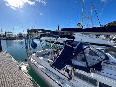

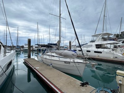

Agreed Johnathon. Our Bimini and targa bar mounted panels are generally completely shade free whilst our cabin roof mounted panel can tilt port starboard to minimise or eliminate shading. The upturned inflatable dingy mounted panel has a reasonably shade free area even part time when sailing and the central fold out Bimini location can be assisted by pulling the boom off to one side.
I have looked at stanchion mounting but our yacht is a bit small to carry them there.
Our EcoFlow portable lithium power pack battery systems allow exact both inward charge and outward power usage monitoring on my phone including graphically which has been of tremendous assistance optimising both power collection and understanding use.
It’s great to watch in detail the instantaneous effect of tilting those panels that can and minimising shade effects on others 🙂
