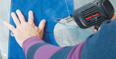

Full polypropylene no wool and you can clean it with bleach. It also dries easily.
Cut it with a rope hot knife and it seals the edges to stop fraying. It stinks when you do it and I doubt the fumes are healthy so take care.

Yes. As others have pointed out, the foam backing only lasts 5-10 years before crumbing, but you can cut carpet at 2-4 feet/minute with a hot knife. Cutting a new carpet is a 5-15 minute job, and you have new carpet!
I tried other edge methods before I started using a hot knife (any 150W solder gun will do it, fitted with the right blade), but the hot knife rules for this.
Hot knife
