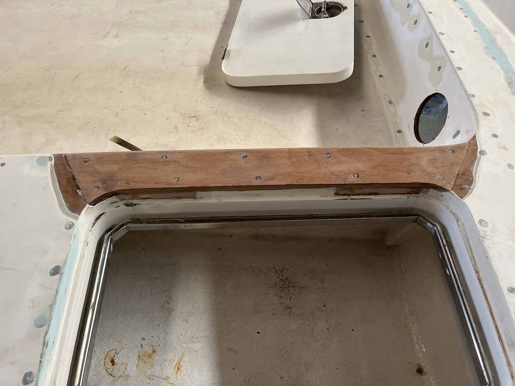

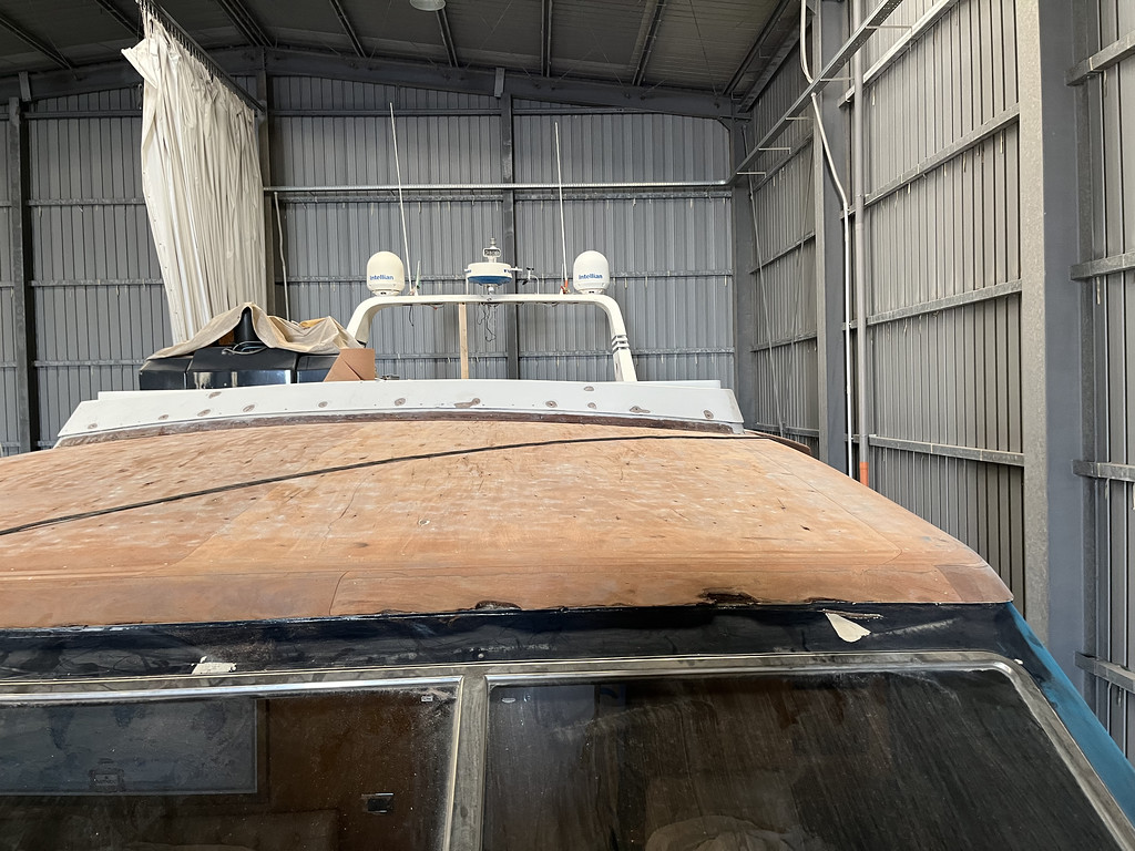

Here is a report of the rebuild of the superstructure,
works that we started last year in September in Yard Sacirn in St Antioco Sardegna.

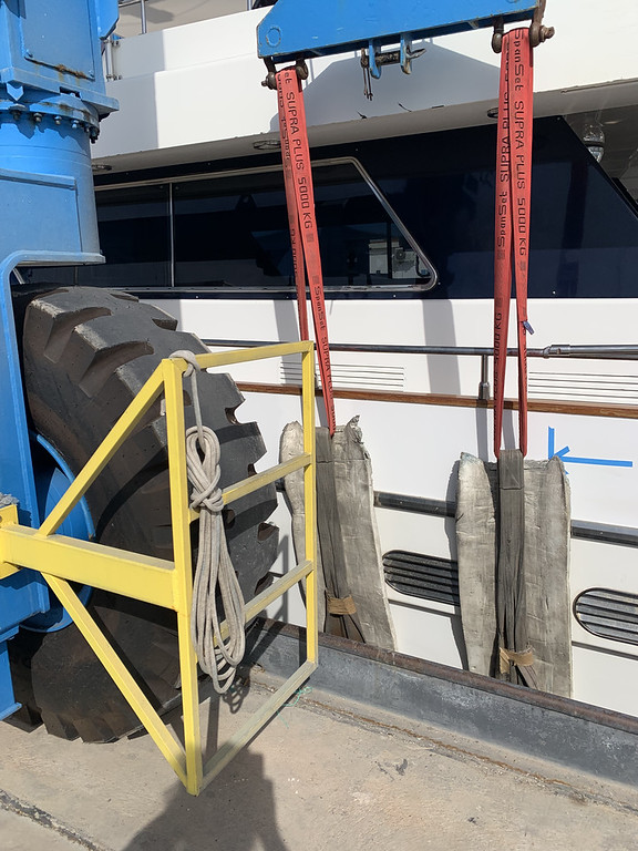

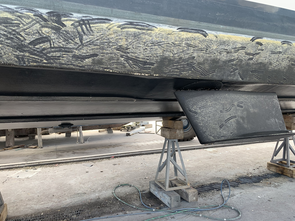

First job was the liftout,
very little fouling as last liftout and new antifouling was done only 4 months ago

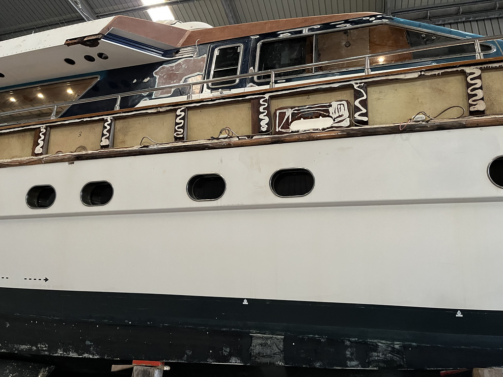

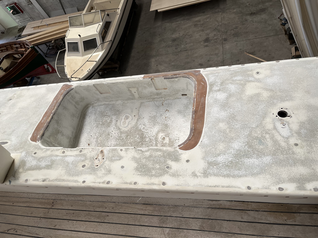

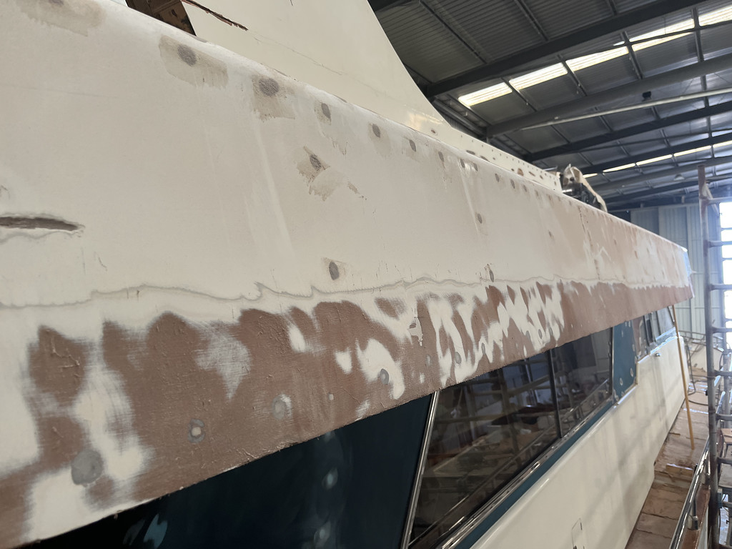

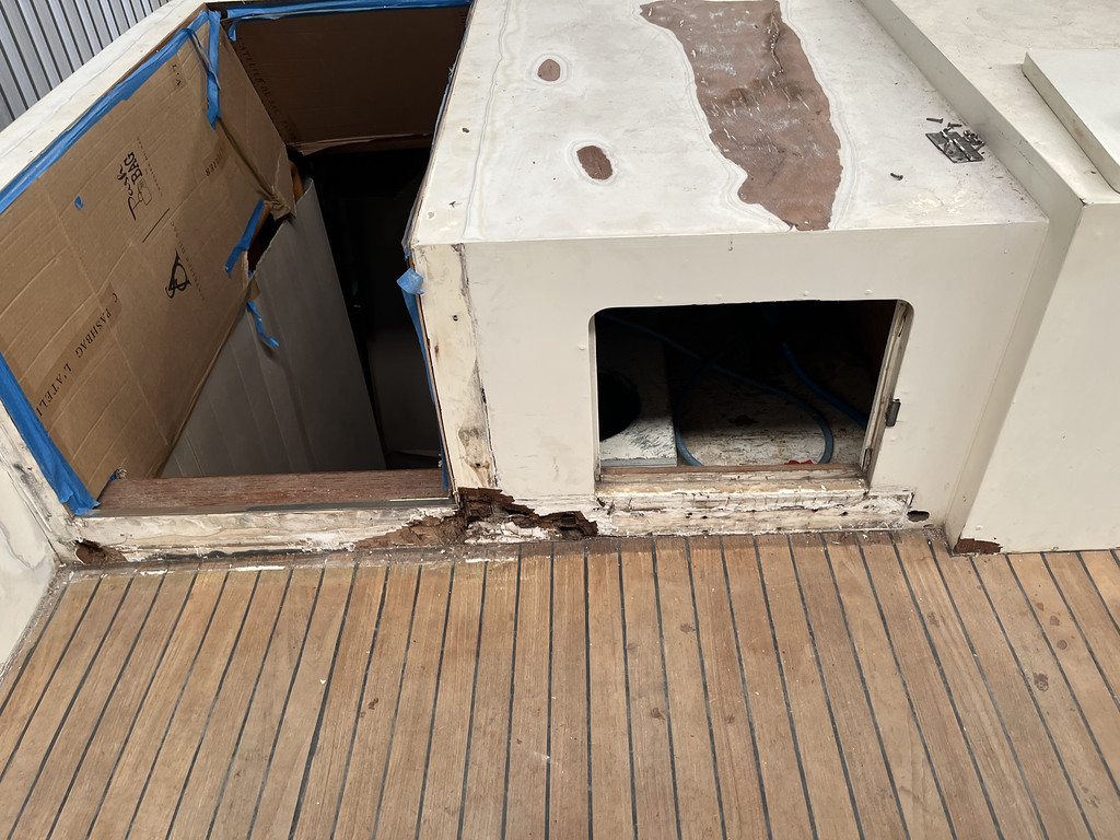

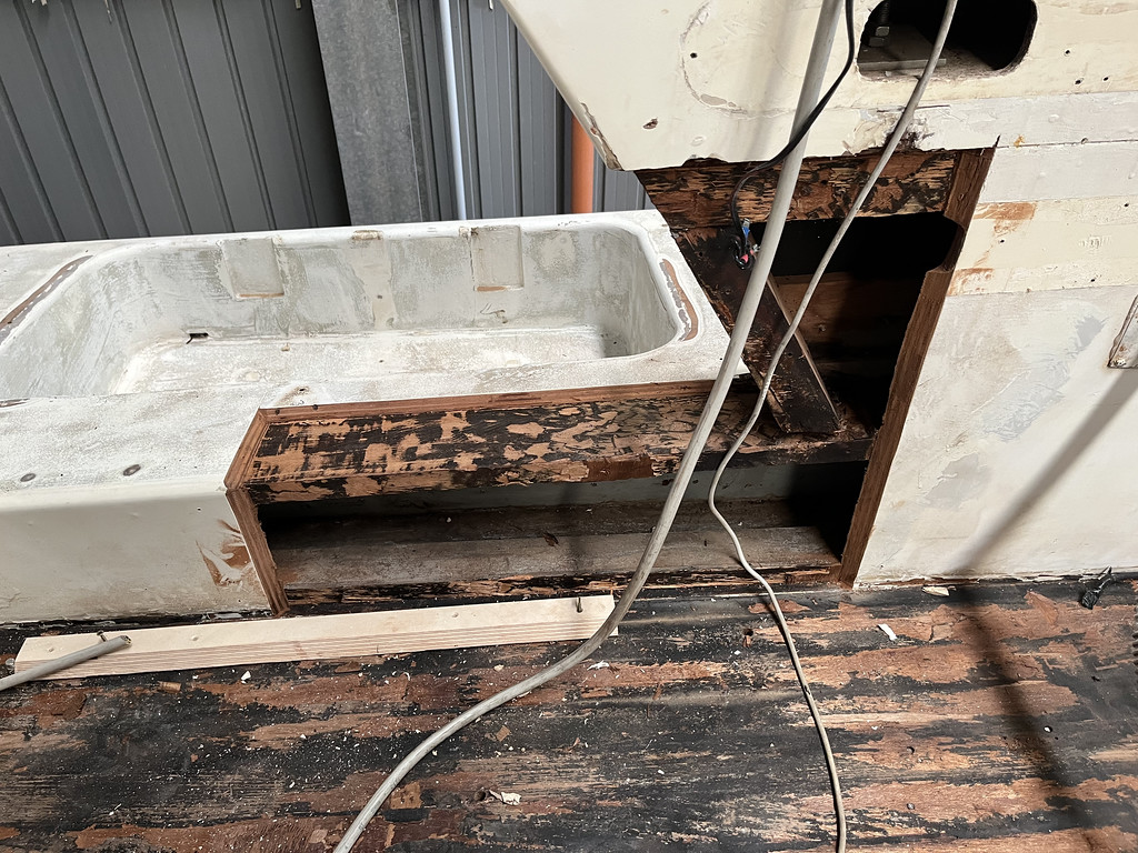

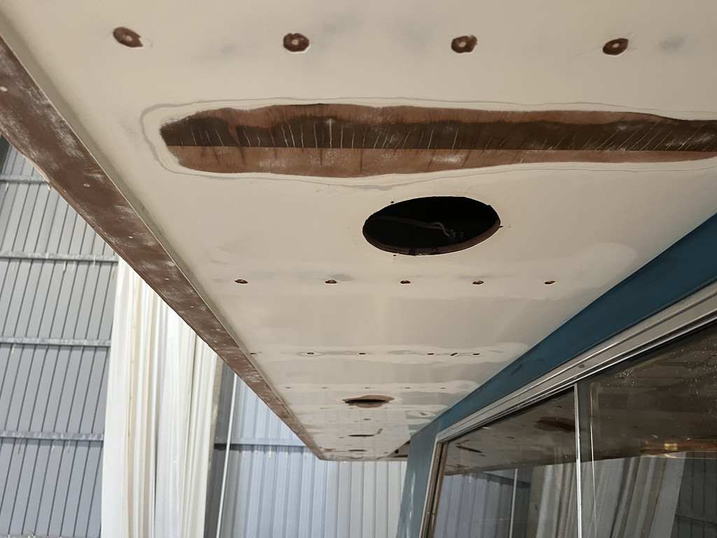

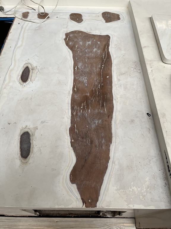

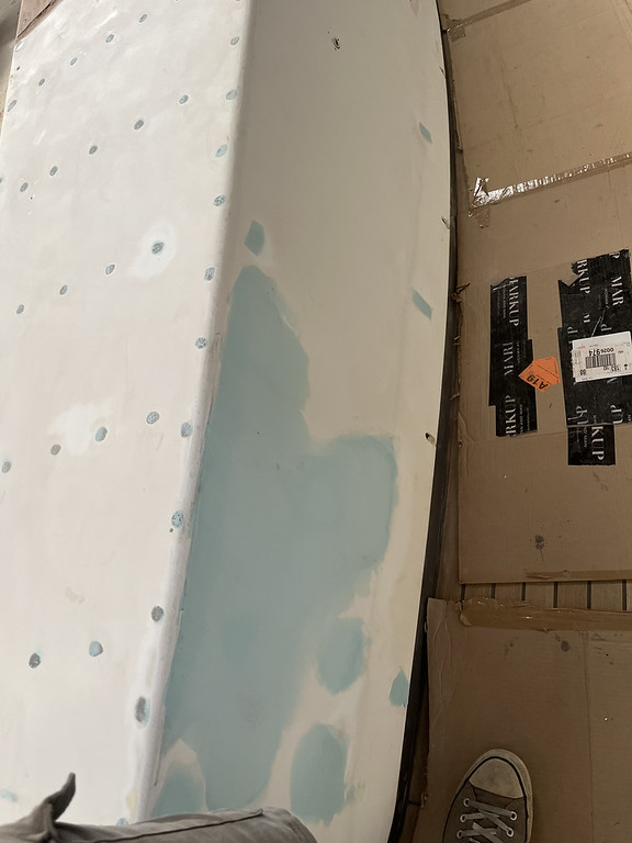

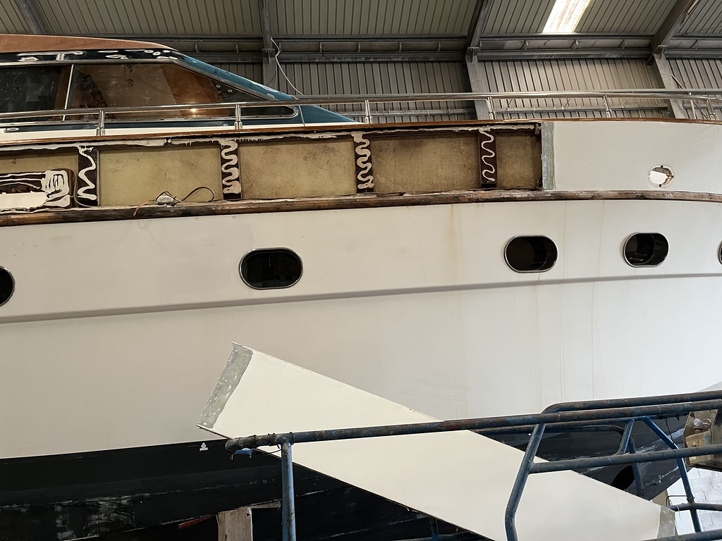

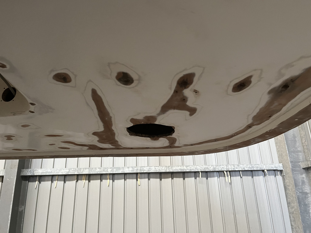

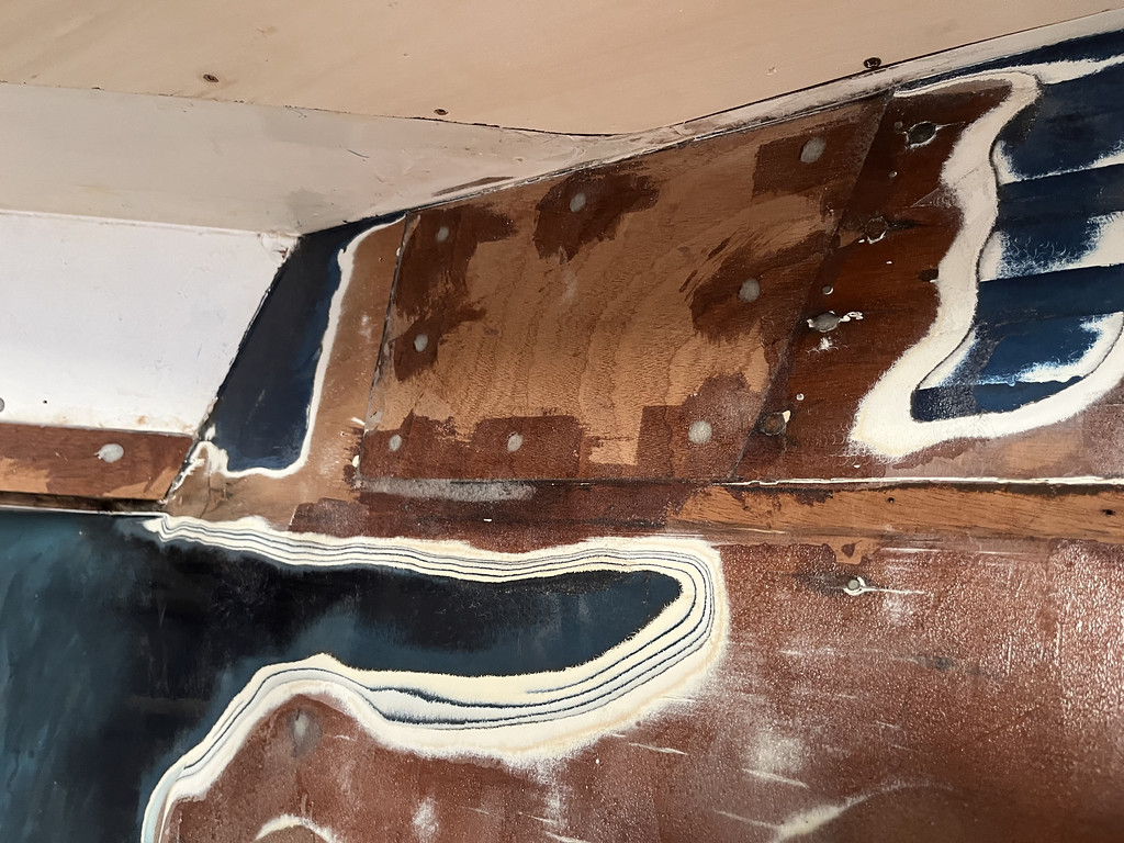

lots of small and large damages and wear is repaired

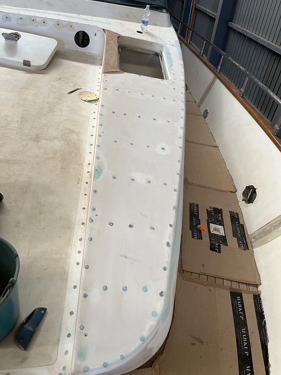

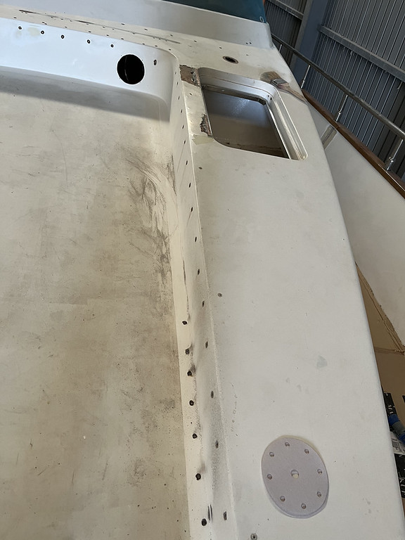

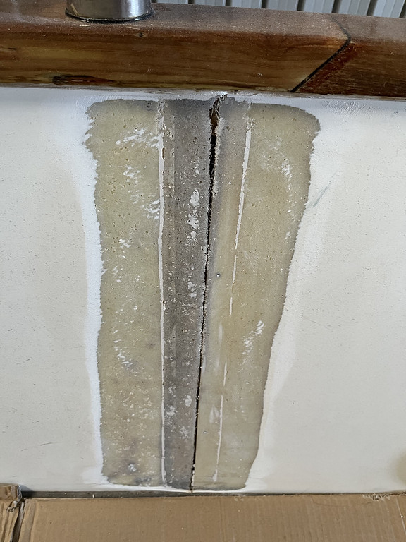

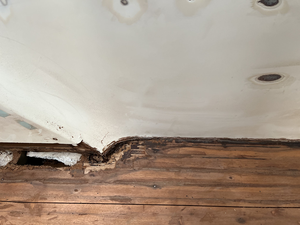

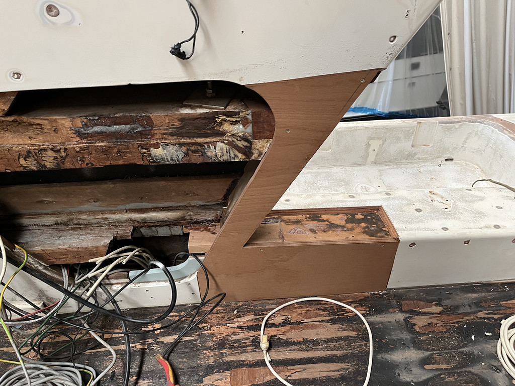

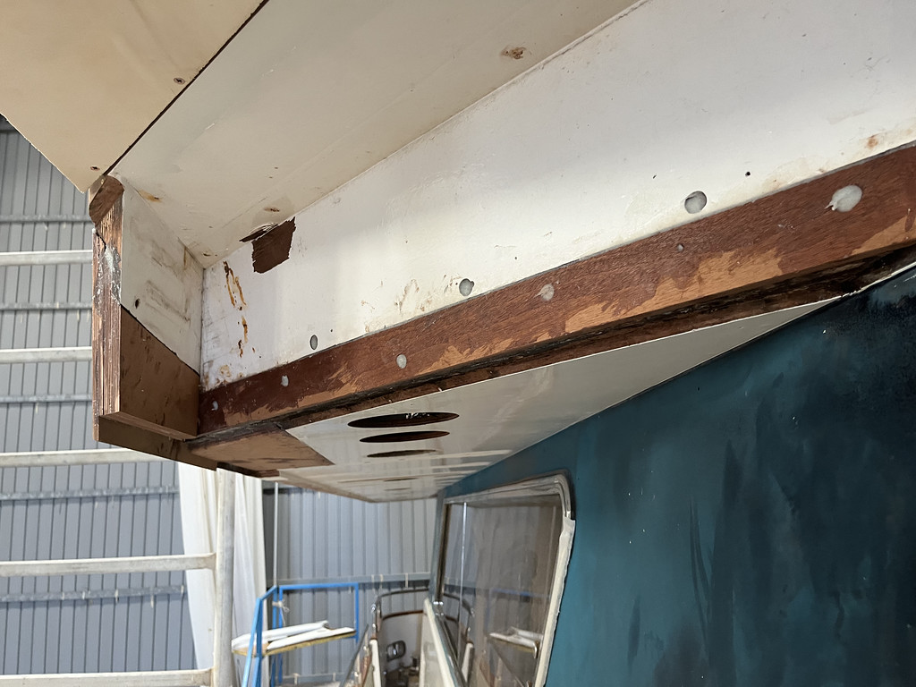

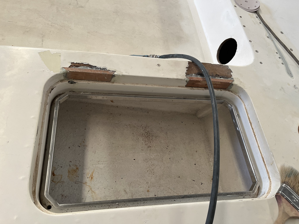

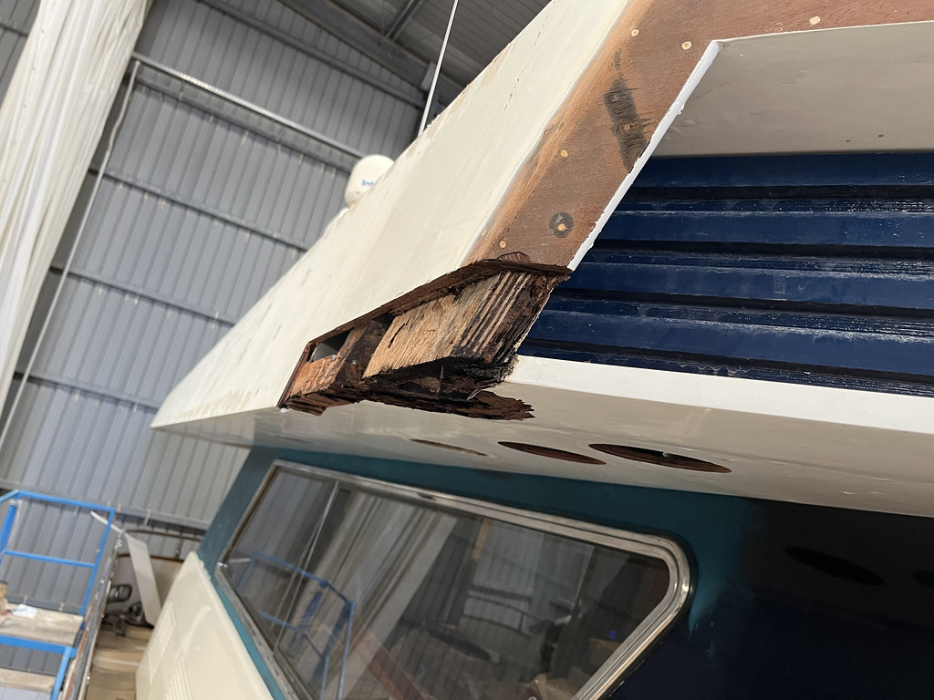

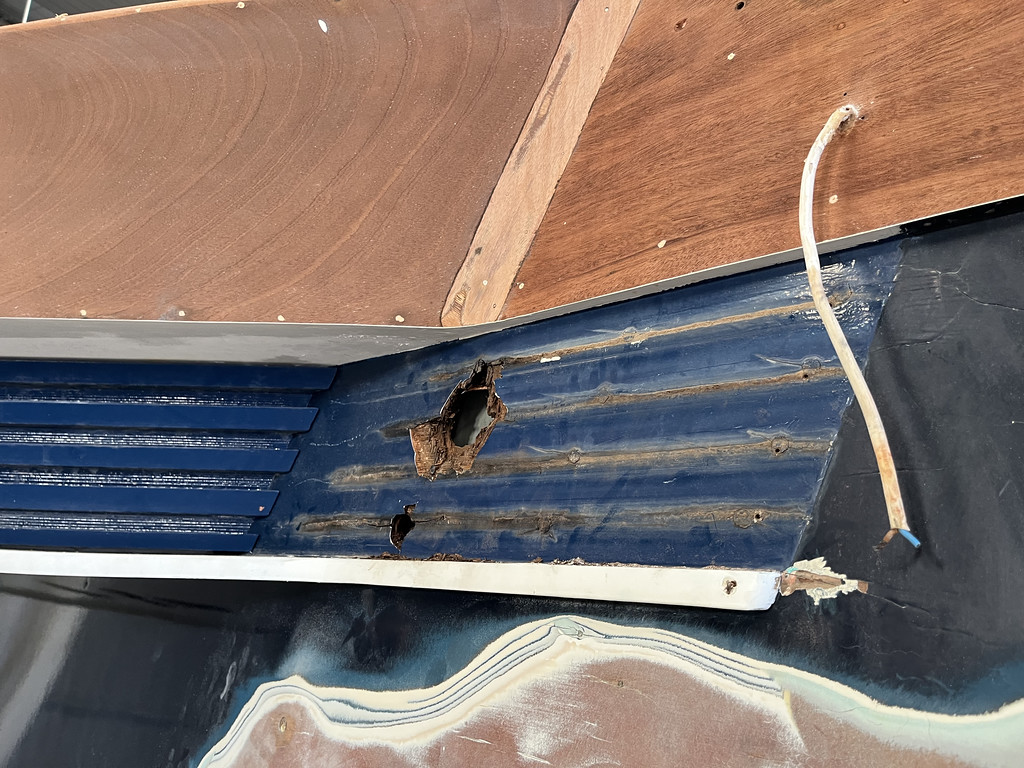

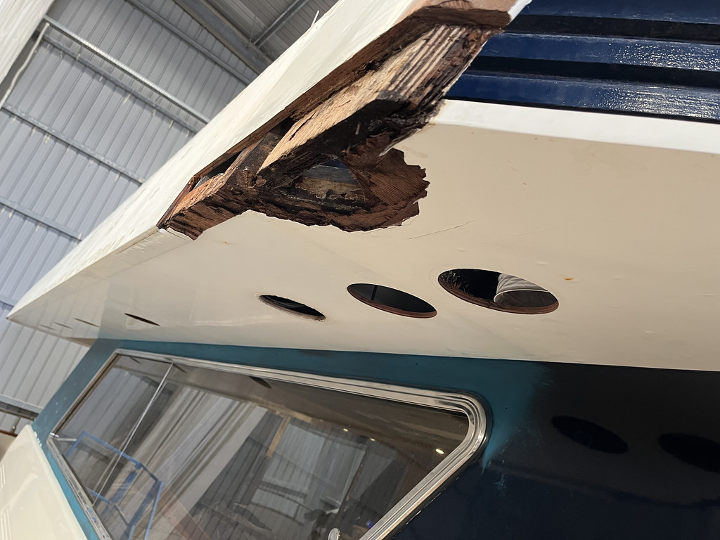

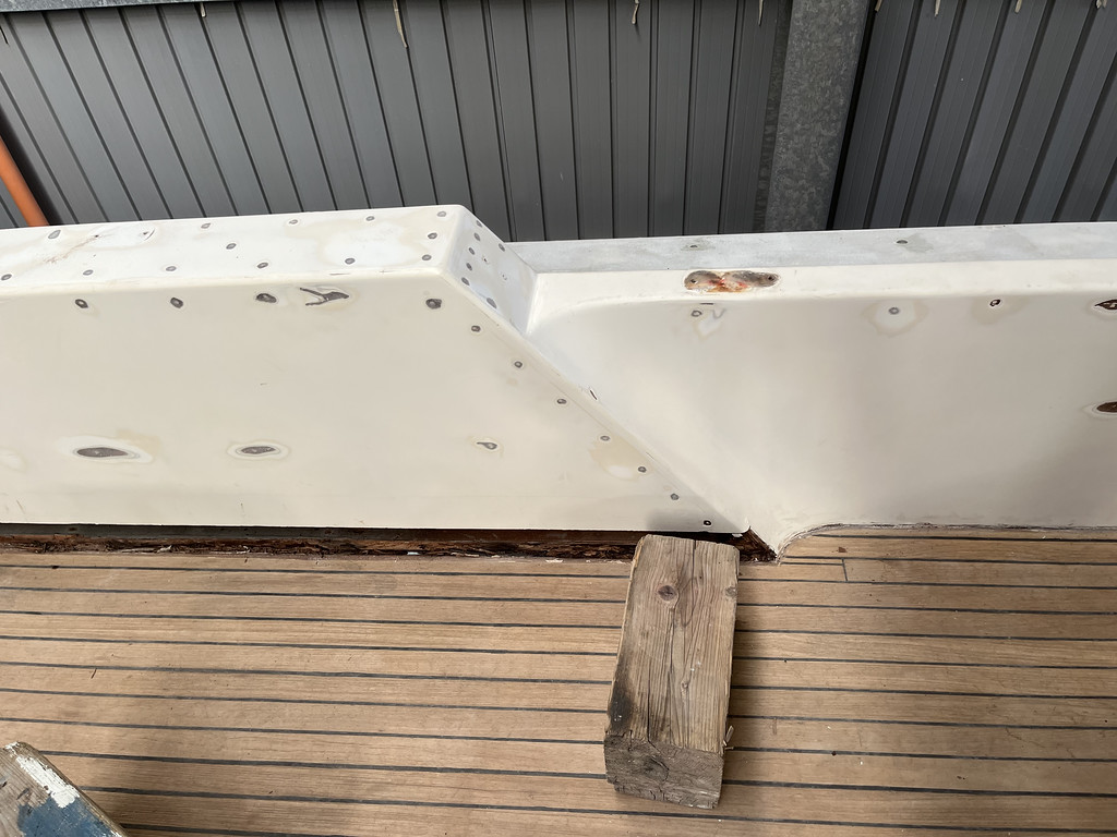

the works we did 5 y ago ao rebuilding the bulwarks appeared not to be done very good,

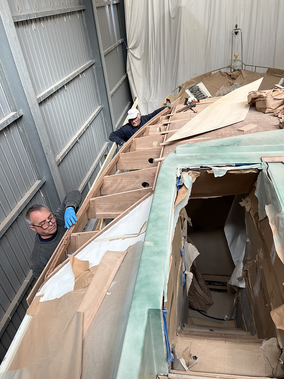

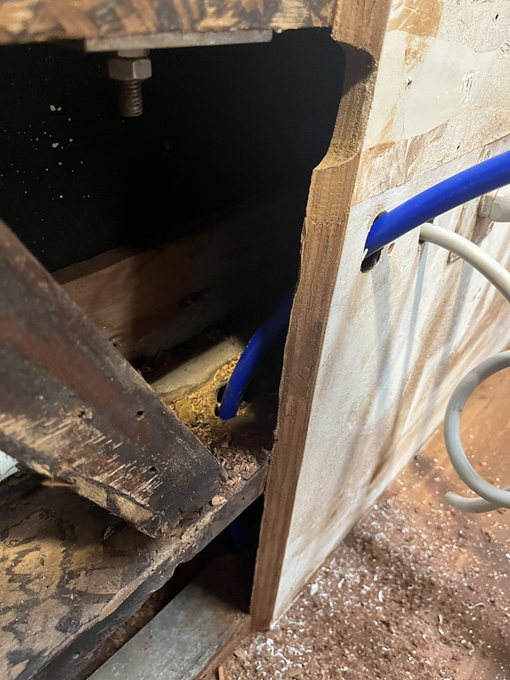

the yard here opened the GRP panels, and found lots of water ingress, and very little bond of the frames to the deck
and glass matt missing on the seams

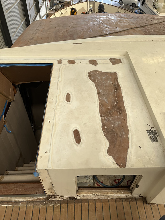

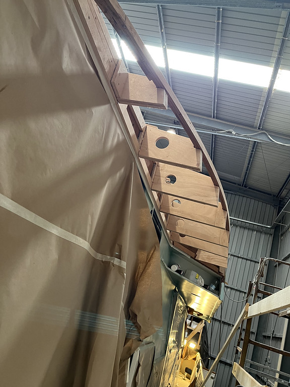

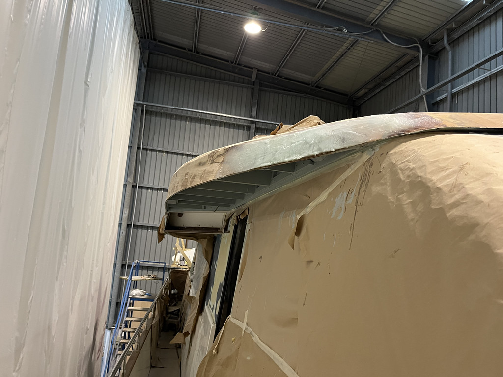

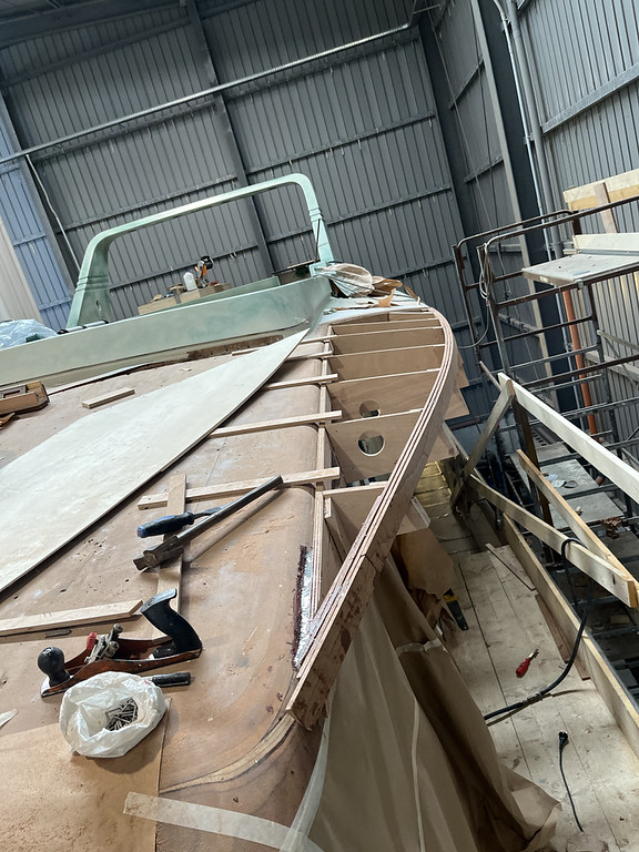

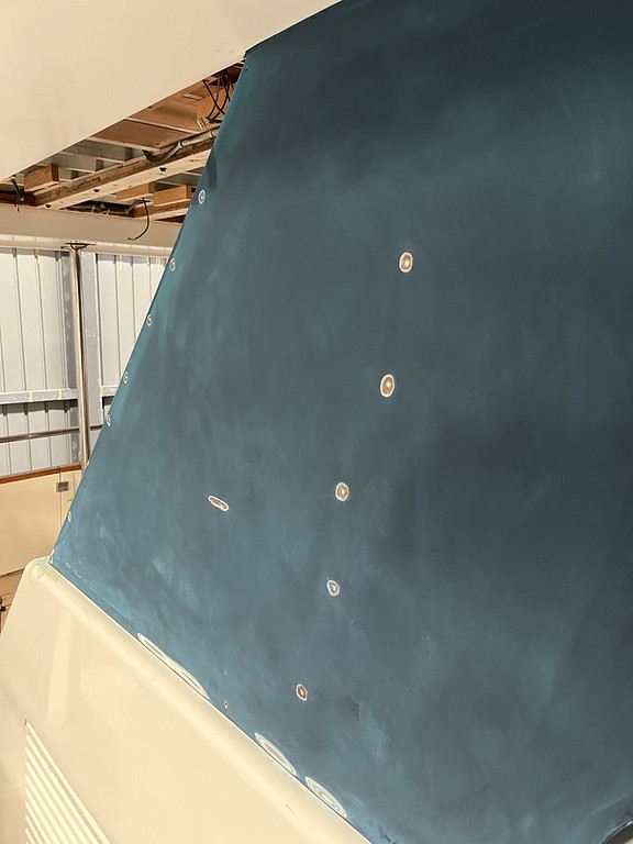

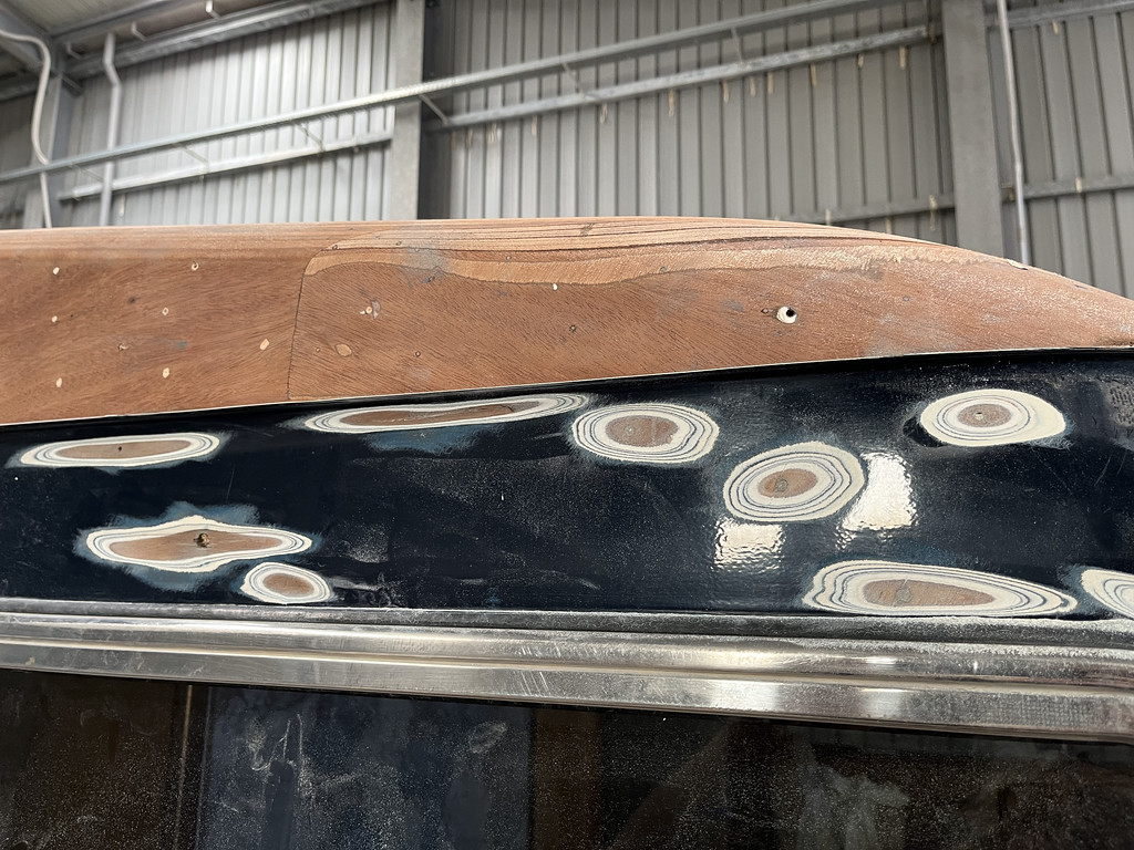

here again many retouches and repairs on the wooden superstructure
should really give us of an overview of the work to be done, bulwarks, f/b, painting the whole superstructure again?

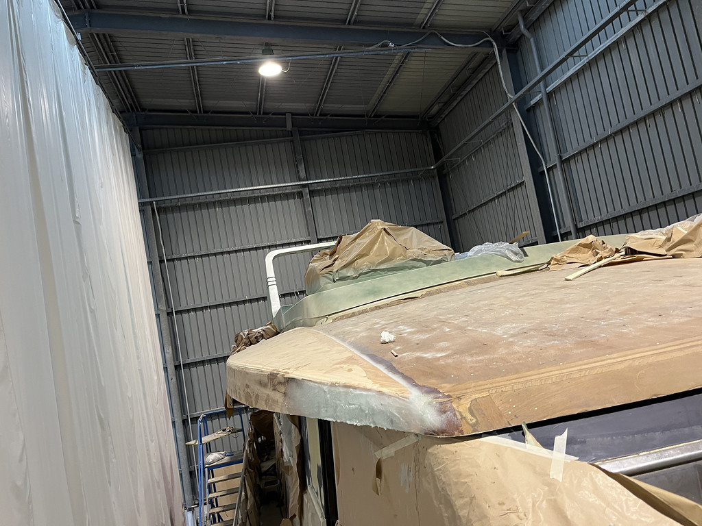

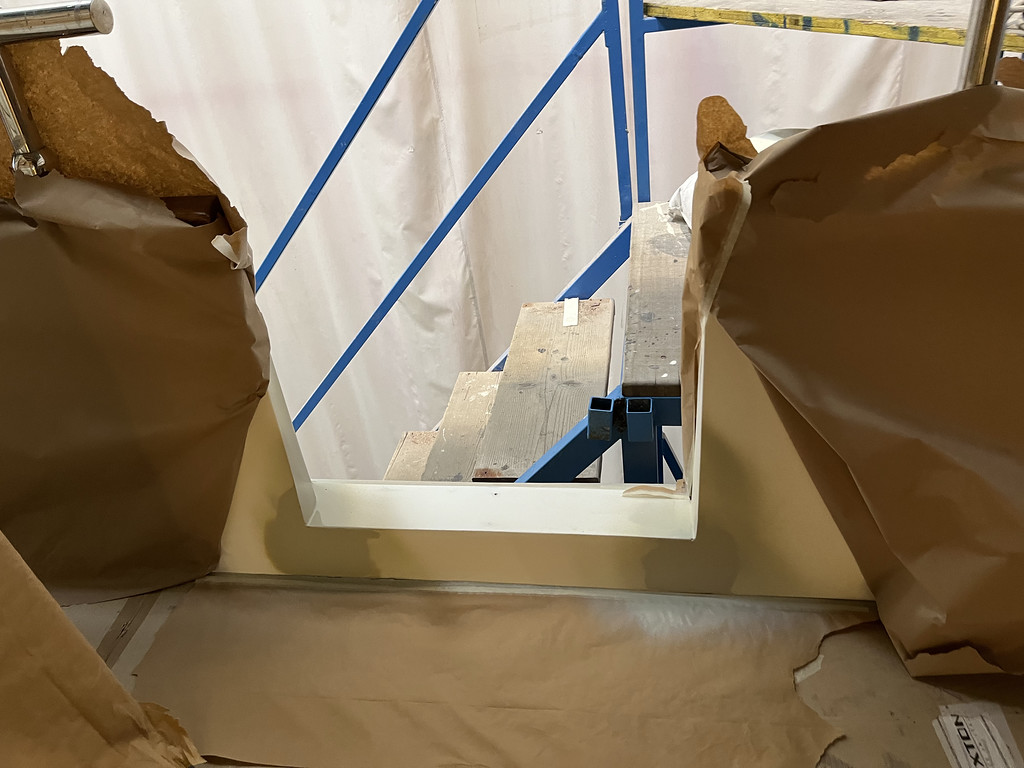

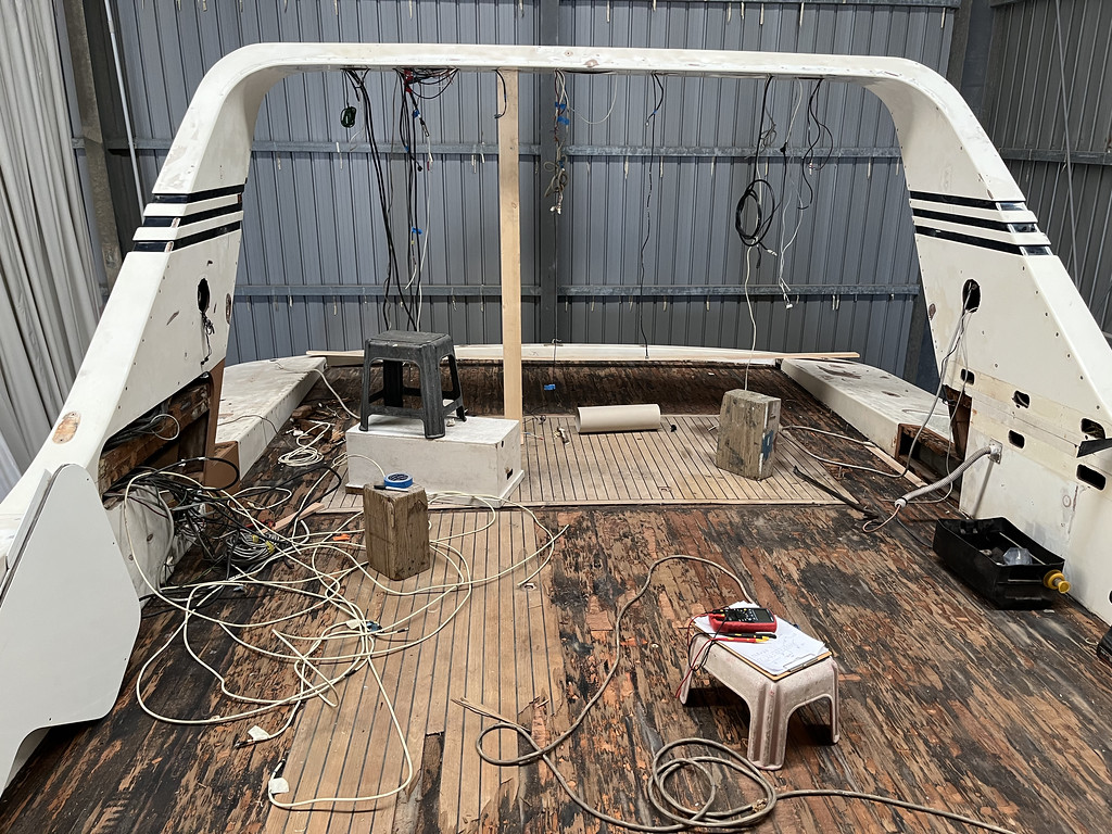

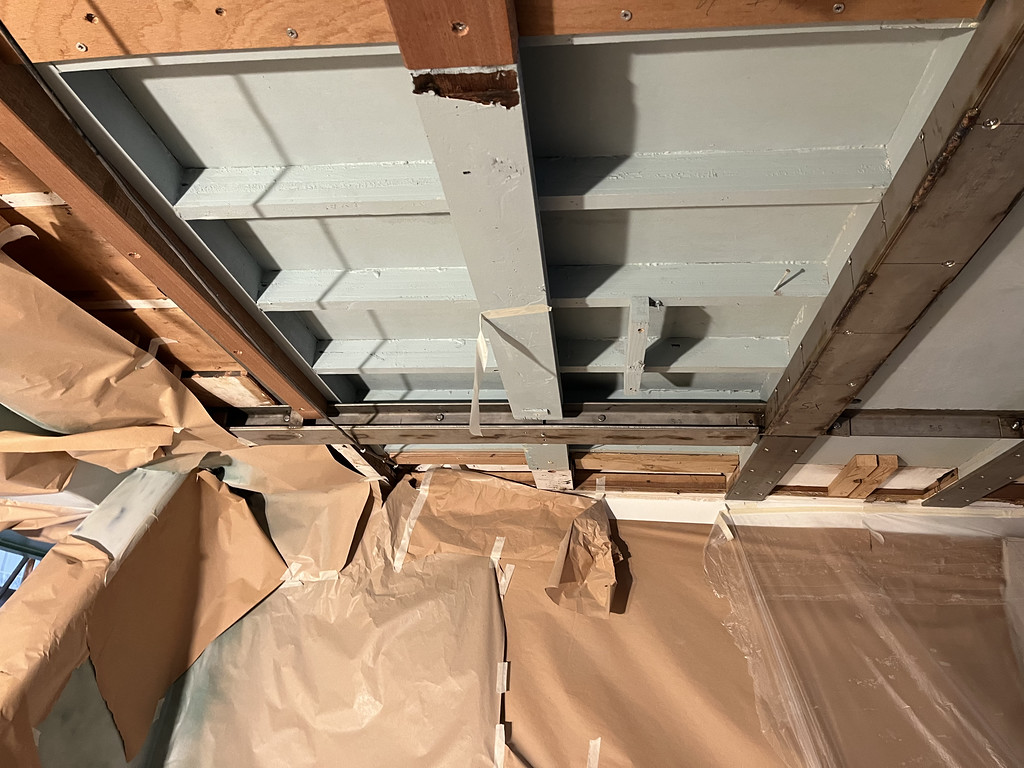

here you see the scaffolding they made for rebuilding the back of the FB border

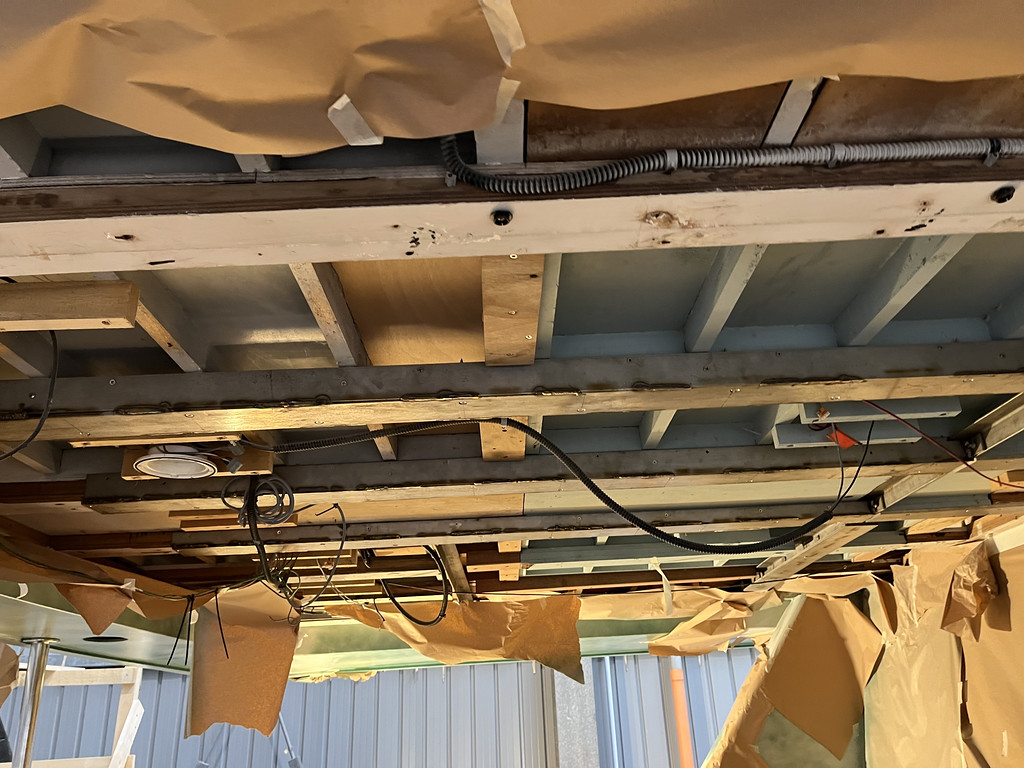

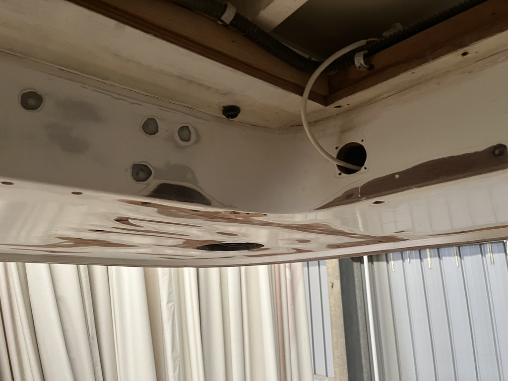

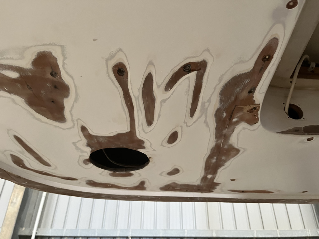

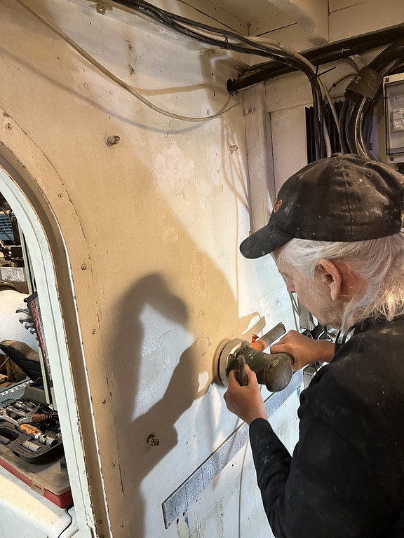

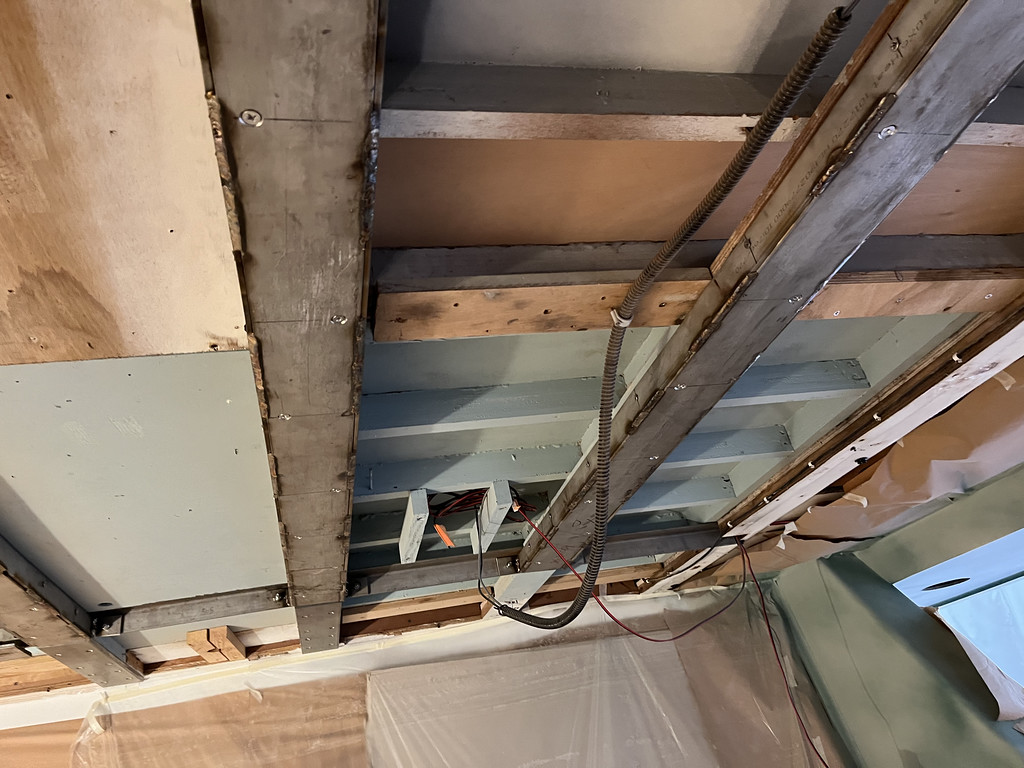

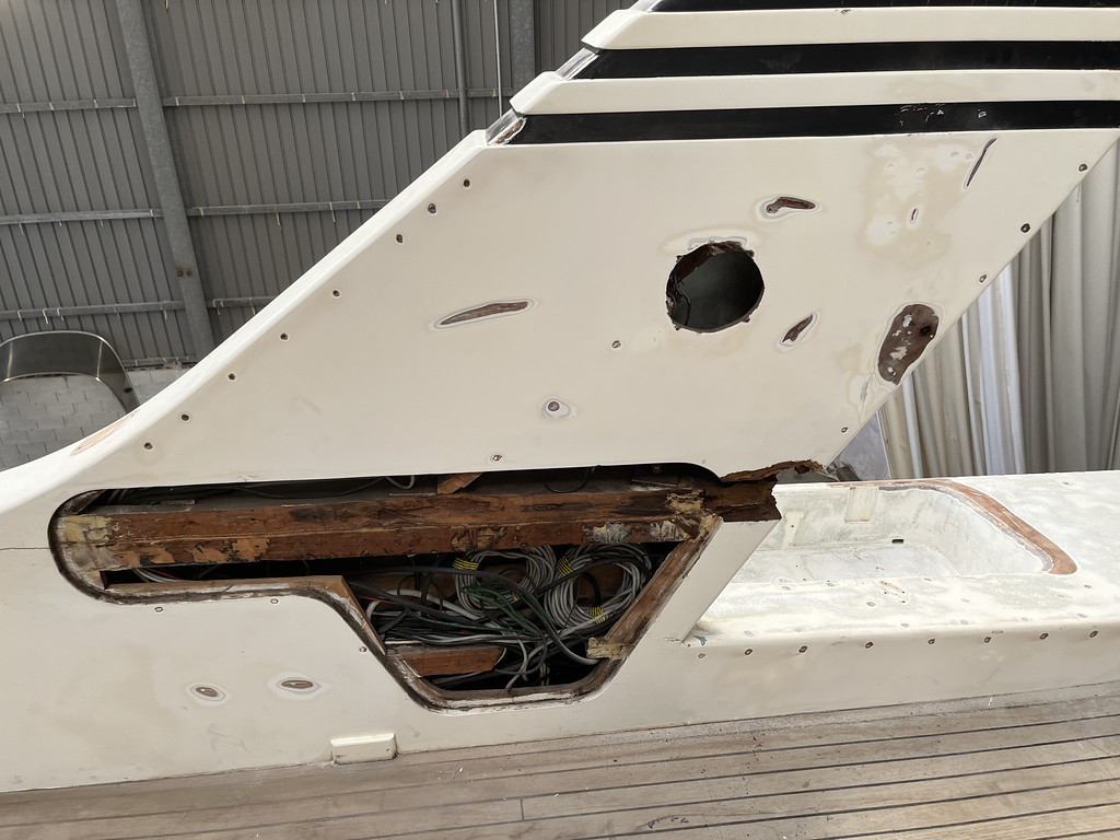

we also asked them to fit some SS reinforcing profiles in the cockpit ceiling, remember we had some cracks there when my son dropped the crane with the tender etc..

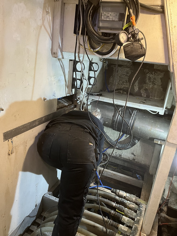

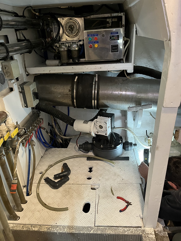

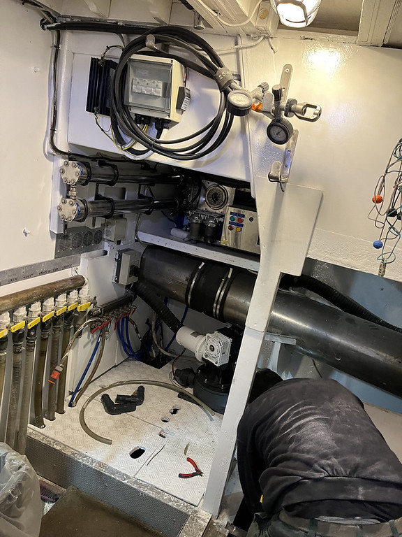

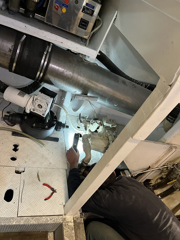

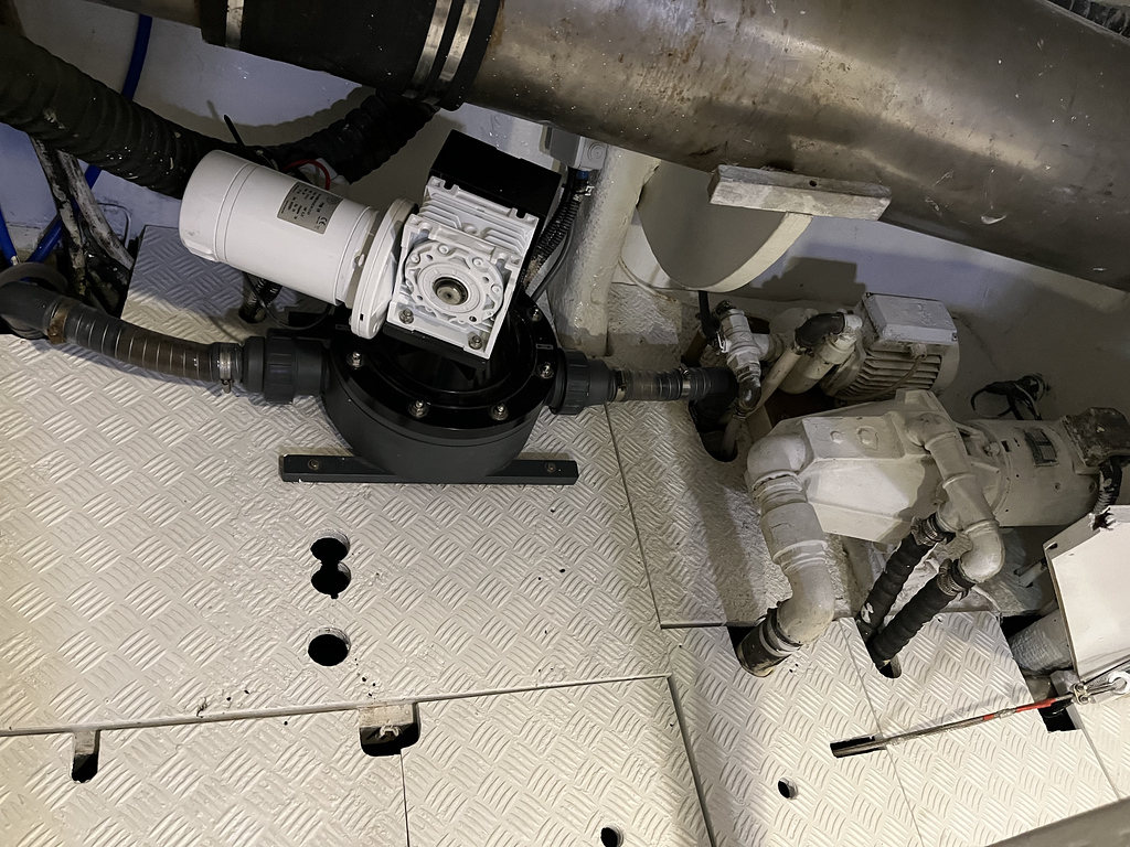

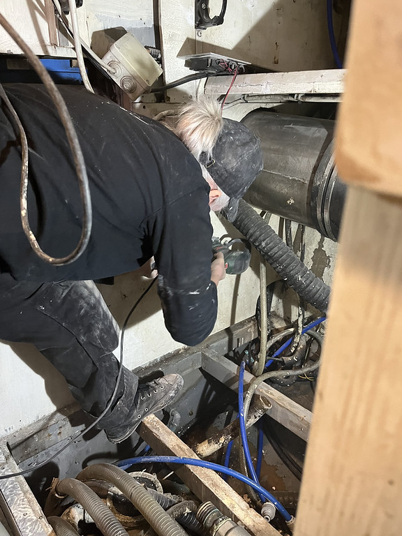

we did some works in ER and Lazarette ourselves,
repainting floor and walls, refitting watermaker and pumps, including big new bilge pump
She’s obviously all wood...but is she covered with fiberglass ?
hull is fibreglass,
Gunwale was wood, but replaced with GRP panels 5...6 y ago, structure inside the gunwale still solid wood, (now extra reinforced )
complete superstructure is wood,
aswell as everything inside the boat. furniture, walls, floor, ...all wood.
