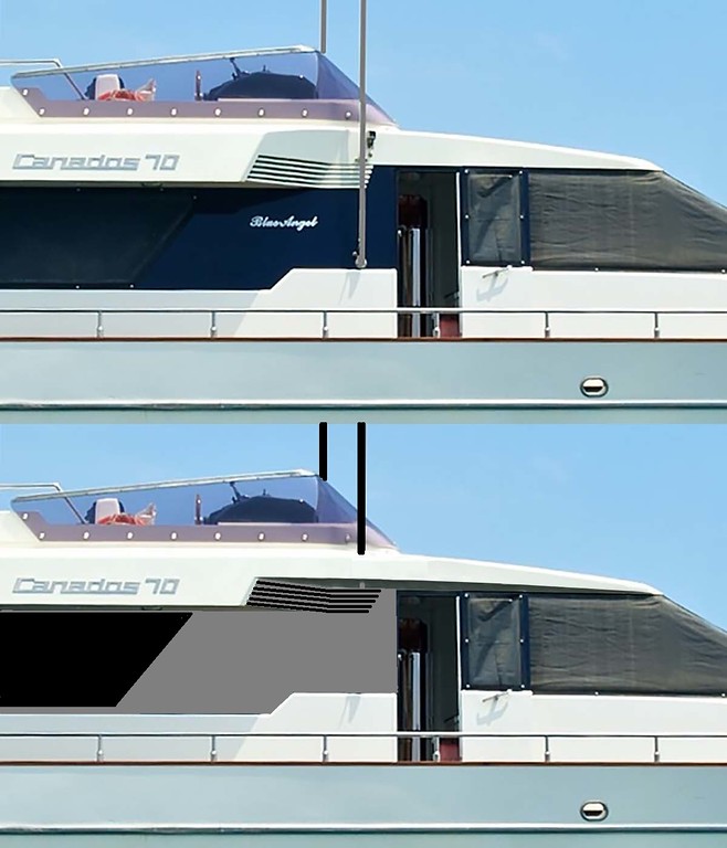

Also, I really love the colour of the upper helm - which I suppose is going to be used also for the band around the side windows, right?

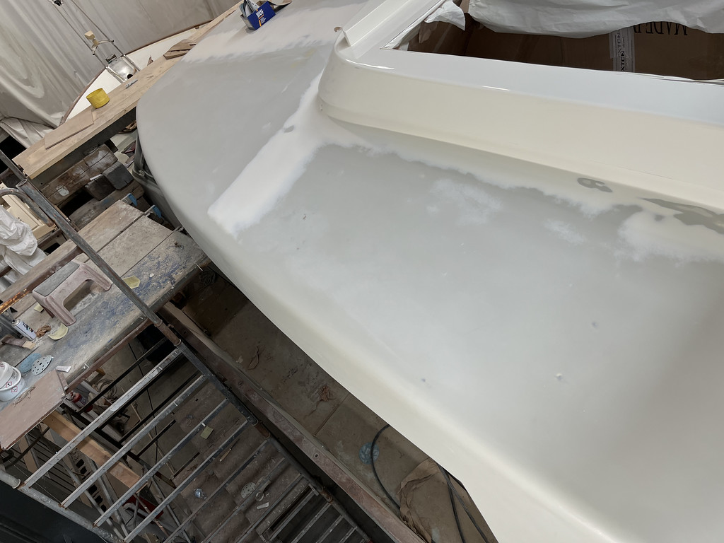

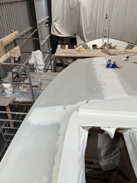

this construction is made from marine plywood, in situ, as can be seen in the pictures. The yard insisted to place a layer of GRP over the helmstation roof, and over those new extensions, bcs the wood from that old roof, was very warn, (still looking fairly good to me) and they are afraid that cracks would show up between the old and the new construction.
so the outside of the wood construction and the rooftop, is now covered with a layer of GRP,
some of the repairs they have done, is plywood epoxyed in place,
but the basic construction is all wood,
I have to say that they put so many layers of paint on all the surfaces, it looks like a epoxy / plastic shell...

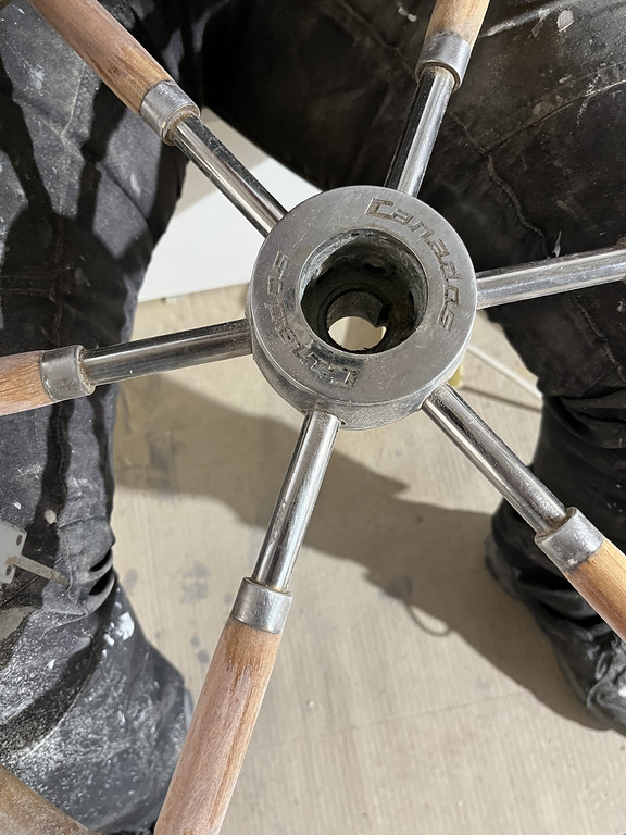

someone sanding the wheel, with lots of passion

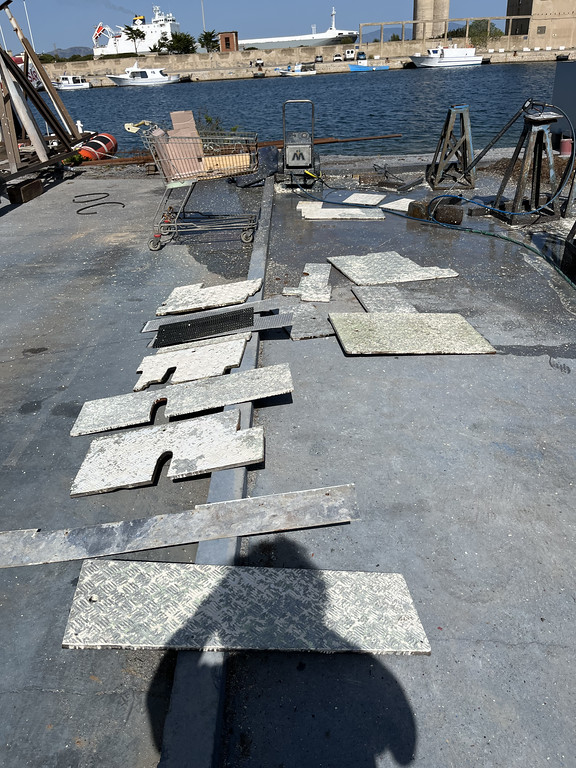

painting of the floor panels in the Utility and engine room (after pressure wash and sanding)

and some random pics on progress with the spray painting
the last pic, shows the new "dark grey metallic" collor that replaces the formerly dark blue areas ao around the windows
