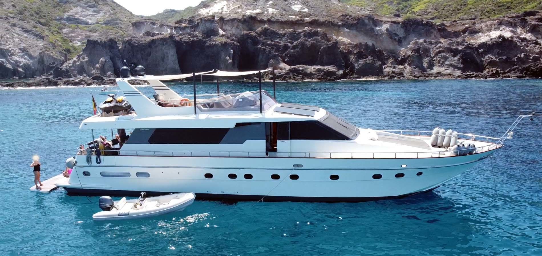

I neither can nor want to substitute Bart with anything he might have to say in answer to that.
But since we recently met, and I believe he's now in an area with poor mobile coverage, I hope he doesn't mind if I post a small spoiler... :cool:

Looks almost new. Love the sunshades. They really look good and very contemporary

Did the refit get finished and are you back on the high seas?
as can be seen in the pic above the refit came together very nice,
in the end it was a bit stress to get the boat ready for the summer, especially cleaning and dealing with many small items,
but we succeeded, (we flew over a few friends from Belgium to help)
and are now nearly at the end of a nice holiday in south Sardegna;
almost 8 weeks on the boat, with family and friends, and no time left to spend here on the forum :)
we are very pleased with the work from the yard, I'll make a detailed picture report later.
we discovered a few technical issues, (nothing todo with the rebuild) ao a very small leak in the lamination near the rudder shaft, (I think thats there already for some time)
and a leak near a depth sensor,
and some old seacocks due for replacement,
so we decided to bring the boat back to this yard,
and keep her on the dry until spring,
and start a new small list of items that need mending.
