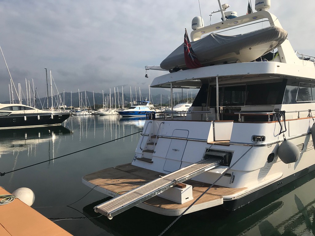

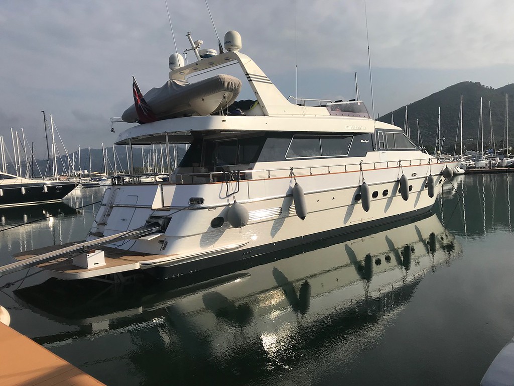

After 5.5months dry under the shed, she ‘s back afloat.
with another forum member’s boat in the background.
More pics from the rebuild will come later,

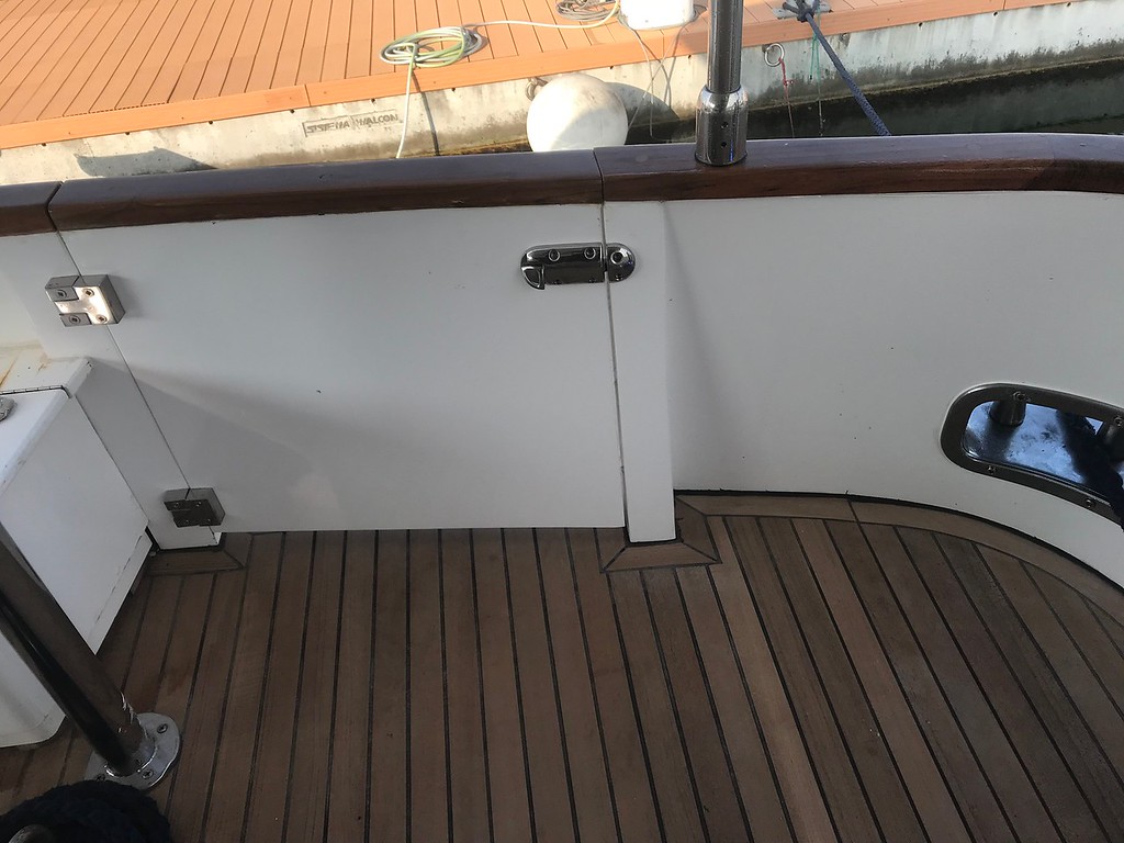

A Engineering question:
Depending on the force and the direction of the mooring ropes in the back,
The gunwale corner flexes a bit resulting in a sticking transom gate door.
now after reinforcing / renewing the gunwales, we still have this issue,
ofcause I can make a wider gap between the door and the gun wale, that’s what we did before,
but each time we made the gate door a few mm’ers smaller, after a while,
the gunwale was flexing a bit more so that the door was sticking again.
I would like to have a system on these transom gate doors, (P an SB) that keeps a gap between the door and the side pole / door frame
But that I can still easily open and close the gate.
Any idea’s ?
Stunning vessel as always, B.
I hope MAFWeiss doesn't mind me saying that his much more modern boat, beautiful as she is, in 10 years from now might look older than BA, which will always remain in her own time warp... :encouragement:
Tricky question ref. the flexing gunwale.
There's one thing I can't remember, was the boat built with those steel poles under the f/b overhang, or did you fit them?
I'm asking because if feasible, you might consider moving them right inside the tip of the gunwale curve, near the transom doors apertures.
This way, you could attach them somehow to the gunwale itself, making the whole structure concurrent and hopefully restricting any movements.
Provided of course that the main purpose of the poles, which is obviously to strengthen the f/b overhang, would not be jeopardized.
I suppose that also depends on the floor structure in that point.
All to be checked carefully, as always for any armchair engineering ideas... :D
Beautiful ship. As for the sticking door, you could put a hinged lifting teak cap like on a ship’s rails.
I couldn’t find a decent image
They are usually substantial with a stainless steel, or brass, hinge and end cap. This could brace the gunwale open.
Or a stainless steel frame around the door opening
Of course much more substantial than this example. Because it will be a open u shape it would of course be profiled like angle iron
BA looking fabulous Bart. Unless you can find a clever way of stiffening the transom, I think the flexing is something you have to live with. You could change the door design to be significantly smaller than the aperture, and then use a canvas cover when you are away from BA. We have this on our Azi.

This is a solution that I didn't think about,
these poles are installed 4y ago when we upgarded the tender you 'll remember we discussed about the best solution for strengthening the FB overhang at that time,
under the floor exactly under the position of these poles is a wood pillar, resting on a hull frame,
but it would be possible to do the same at the other side of the steps, actually it would be a good idea to do that under the floor reinforcement there anyway, ... would probably cure some of the gunwale bending. (not 100% sure) but extra reinforcement would not harm.
I considered moving the F/B poles to the sides for another reason; looking at the back of the boat, it seems that side overhangs, are bending down by their weight, (+ tender + rafts, ...) but I found out that this shape is in the design, so we didn't move the poles, also because it would impede the handling the lazy lines...

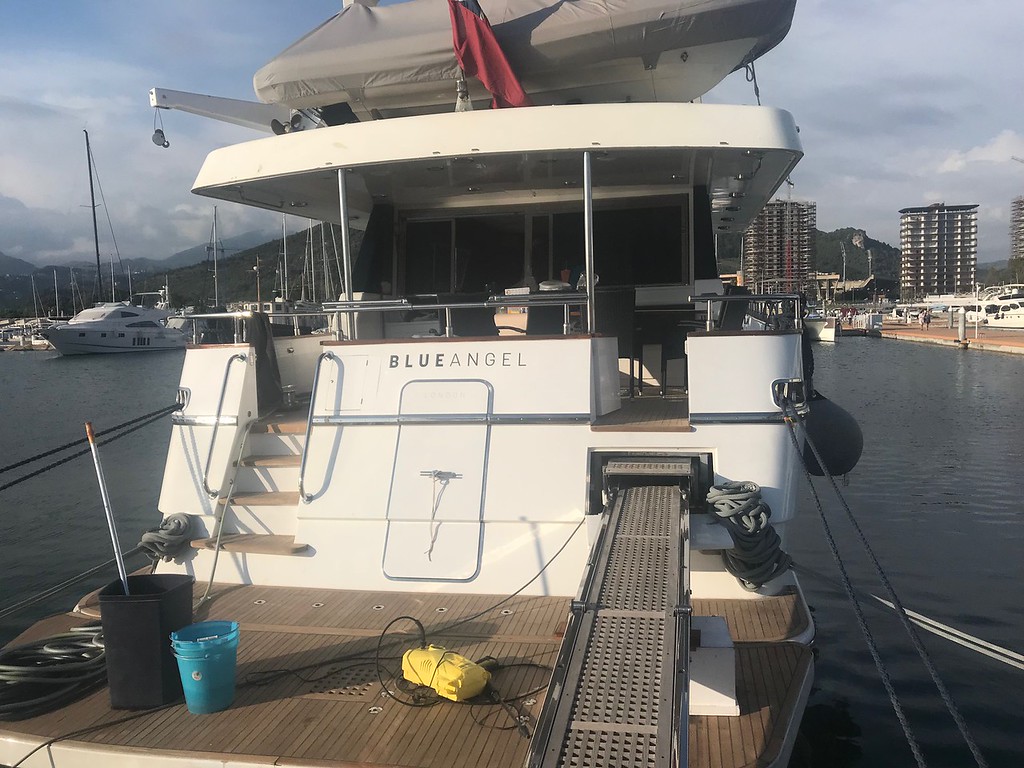

do you like the new boat name ?
this is a first test, just with adhesive letters,
mixed opinions here, but I absolutely like it,
yes the port name (on the door) migh be a bit more solid, ( but who cares...)
but I like the "finesse" on the size of the name letters
my only doubt is about the letter top surface color,
now it is dark metallic grey, (we have / will have more of that on BA in the future)
so options are: polished SS, or black, or metallic grey
imo:
polished SS = so common, everybody has it, the name doesn't stand out from the SS construction details on the boat
Dark metallic grey = ?
Black = might be a bit "intrigueing" , but perhaps a bit to harsh, ...
unfortunately no supplyer can make the light letters so thin (so far)
so I'm not in hurry with that
