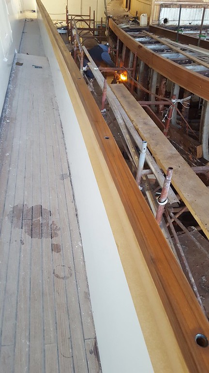

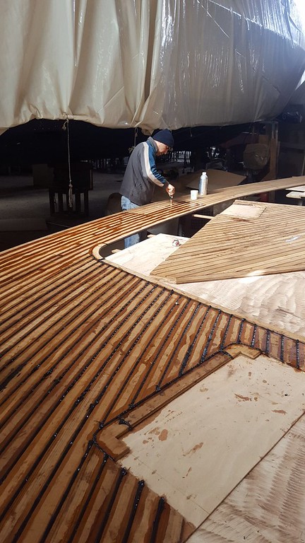

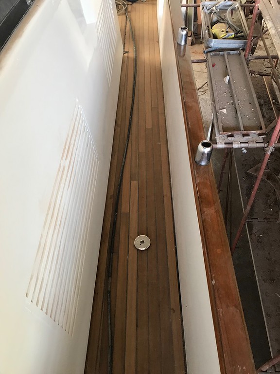

Remember they started preparing the new teak floor
Template for fix platform

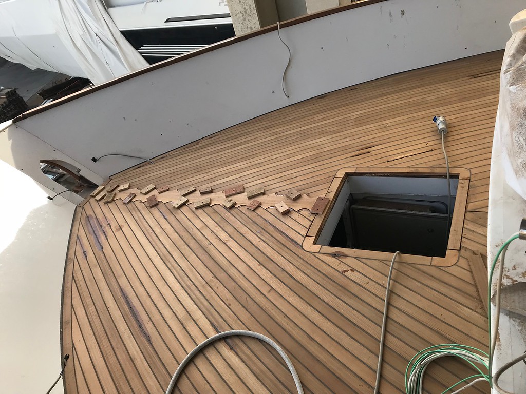

Finishing and installing premade Teak Panels for the deck

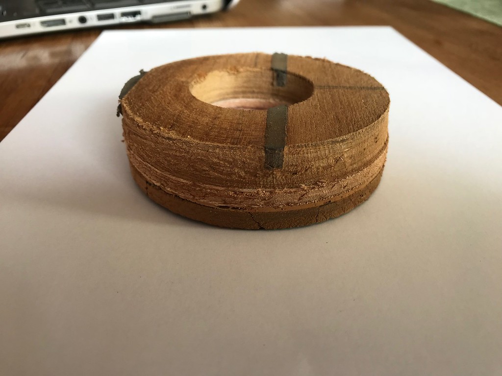

This is interesting; cutout from the winch,
From top to bottom:
12mm new teak, with 6mm deep black caulking groove
0.5mm epoxy glue
4mm ply underpannel
1mm glue
4..5mm old teak (which they didn’d remove unfortunately)

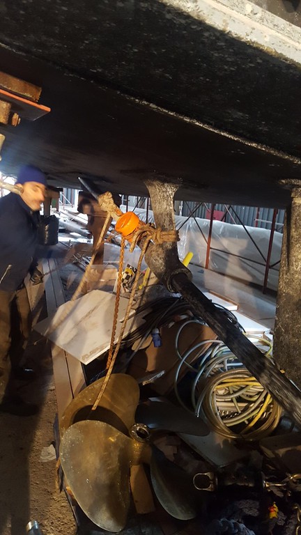

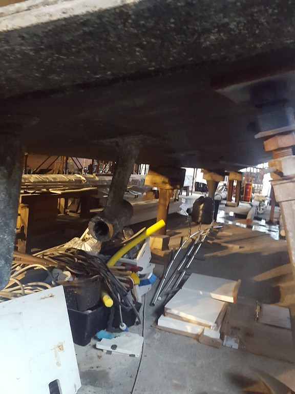

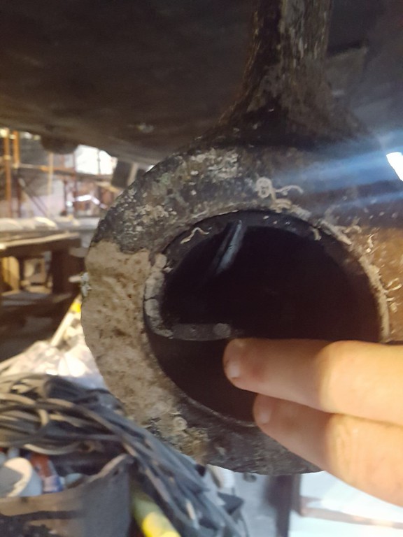

We had a tough discussion with the yard regarding replacing the shaft seals,
Initially we didnd agree to place new seals, as I insisted on Tides Marine seals, which they didn't know, didn't want.
But in the end I’d got wat I want.

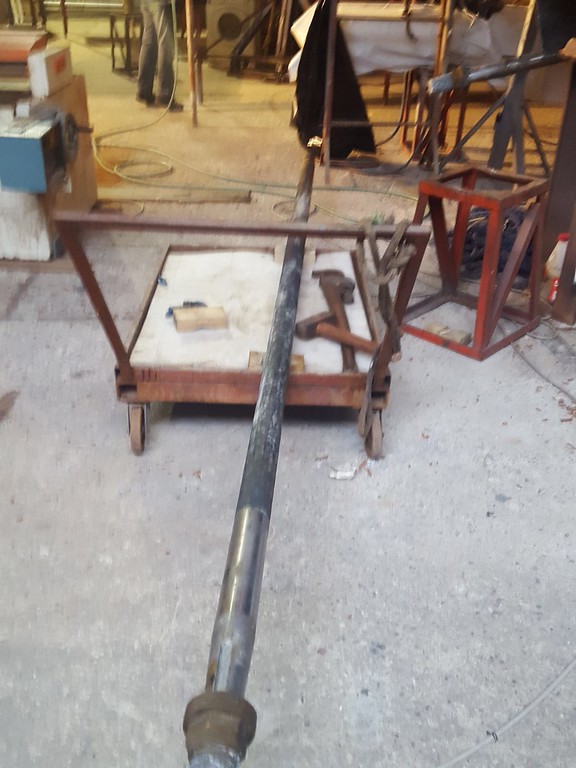

Refitting of the shafts and seals

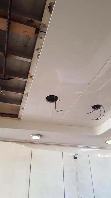

New grp cockpit ceiling

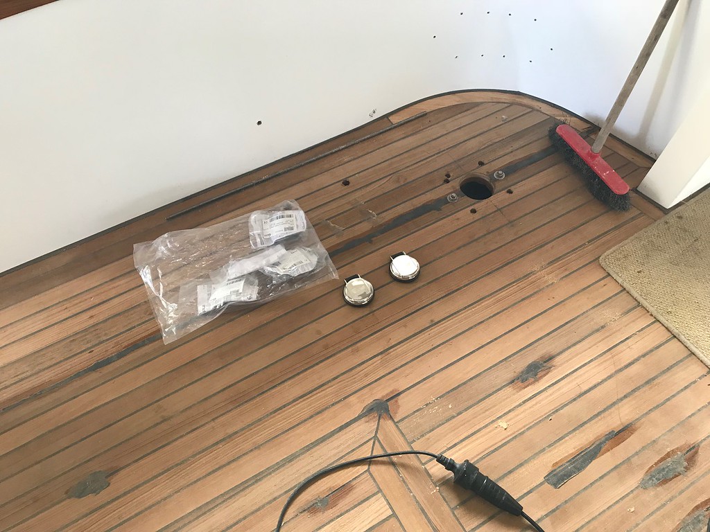

Refitting fairleads and deck lights

Just a few comments/questions/curiosities:
1) Any particular reason why they didn't remove the old teak? Fear to make worse damages, maybe?
Not that I see it as a big deal, actually. BA is already a heavy boat anyway, I'm sure she will take a somewhat heavier deck in her stride!
2) Why did they cut the caulkings and sand the pre-made deck panels before putting them in place and finish the job?
This is going to require an additional sanding I guess, at least in some places.
Again, no big deal, anyway. With 12mm you should be good to go for another quarter of a century...

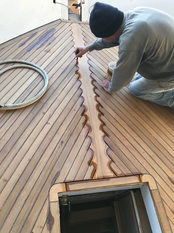

3) Generally speaking, the attention to detail is even better than I would have expected from a yard which isn't focused on high level pleasure boats, for what I can see from your pics.
I could spot just a couple of things which could have been better: one is not having made a border around the deck fillers, but this is very trivial.
The second is actually funny, because it is obvious that they know exactly how it should be done correctly, so someone must have cut those two small bits on a friday afternoon, I reckon.
I'm talking of two of the four corners of the border around the crew cabin porthole, and I won't say more for the moment.
Let's see who will "spot the mistake" first... :rolleyes:
4) Ref. the shaft seals, were they suggesting to stick to stuffing box, or did they suggest any other type of mechanical seals? And if they did, what was their proposal?
I'm asking because I half remember that they deal also with the maintenance of patrol boats, in which case they probably know Fluiten better than Tides.
And in spite of the fact that the first are much less known than the latter in pleasure boats, they are actually excellent and arguably superior, in most ways - albeit awfully expensive. Don't ask me how I know...

Thank you all for the kind words,
They are indeed good traditional craftsmen, but unfortunately they miss a bit of the finishing touch for working on a luxury boat (or is it me who became too much ocd after spending too much time here on the forum :D )
Re questions from MapisM
1) I was promised from the very beginning that old teak was going to be sanded away, but leaving some teak in erea’s where the surface was not perfectly level or sloping in the wrong direction. I was very disappointed when I realised that they just sanded it level, and placed the new panels right on top of the old teak, and missing the opportunity to repair a old deck sloping problem…which I showed them clearly during a previous visit.
That sloping problem is partially cured with extra sanding, and a extra deck drain, (I’ll explain later with other pics)
The reason why they left the old teac is just because its less work,
and taking away the old teak might have created additional problems, more risc for leaks (?) they said...
The structure underneath was checked and approved ok appart from the side steps, and a zone near the anker winch which have been repaired.
So additionally to the ply under-panel, there is the extra weight of 4mm old teak (roughly 300kg extra weight) on the deck, which I don’t like.
2) The teak caulking grooves were made on each individual plank, with a machine, before the planks were placed in position,
And the premade panels were caulked and sanded before these were placed in postion on the deck,
all for easier and more efficient working.
There is indeed some extra sanding required on the seems, and bad caulking spots, but I think this is not a big deal.
3) Tbh the teak workers were good craftsmen, but lacking an eye for detail, and not enough experience on luxury pleasure boats
I guess you are talking about the wood grain, not all the same direction ?
like that I can give you plenty of details, ..
Actually the first version of the crew cabin porthole teak border, they just started to make them square, I was able to asc for round, right in time, at the same moment I asked for the honeycomp center plank on the bow, they intended to make all that straight, but were delighted to give it this signature.
When they made the cockpit panels, I was not there, and there they made some silly choices….

Fe the new cockpit ceiling panels;
originally they were ply, with seems of exactly 1mm everywhere , CANADOS factory made.
I refused to accept Sikaflex in the seems of the new grp ceiling panels, they had to redo quite some work on these, haven’t seen the final result yet…

4) For the shaft seals they wanted to use PSS.
I was determined on Tides (also after talking in the past with Ilko, etc.) . I knew these would be good,
With the PSS one can’t have spare seals around the shaft, and the rubber needs to be replaced every 5y says the manual…
