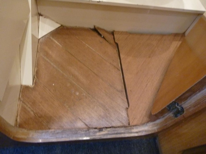

We are replacing and or changing some wall and floor panels in the crew bathroom,
The old panels look used and damaged, they were made from marine ply with Formica glued on top.
My friend experienced carpenter (but not on boats) wants to use green MDF (water proof hard / fibre board) whith a high quality lacker, or a teak layer on them.
It’s the compressed wood fibres product that’s often used to make custom kitchen furniture, don’t know the right English name.
I’ve never seen using MDF in boats, so I’m not sure if this is a good idea,
I’m afraid that this product is not stable enough and not water resistant enough on long term.

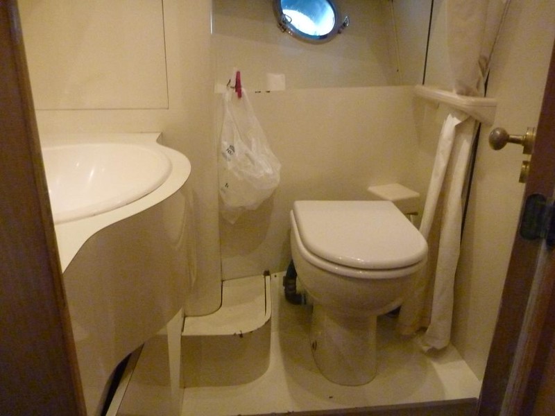

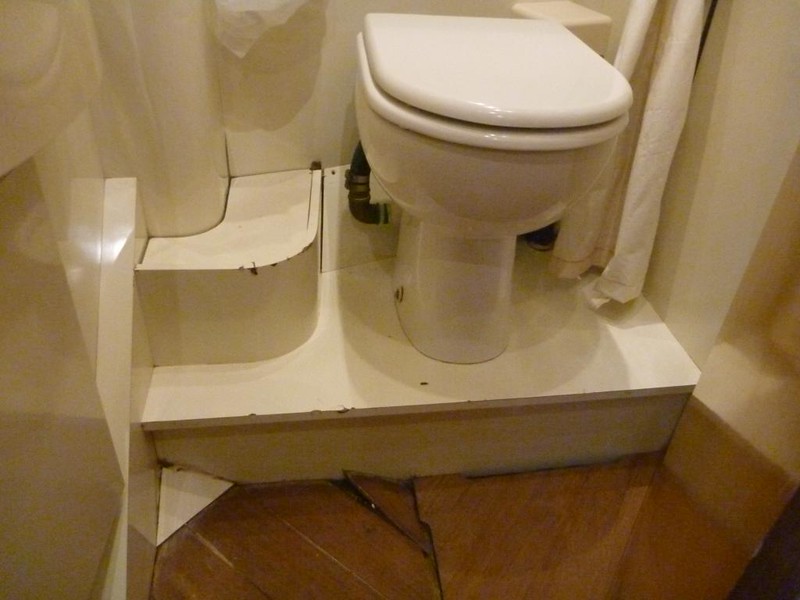

Here is a picture of the old situation, the complete toilet corner had been taken out, (no picture yet from that) and all panels will be made new.
The geometry is slightly changed, so that the toilet is more backwards, so that your feet can be on the step when sitting on the throne.
The step below the toilet will have 5mm teak on top, just like in all other cabins.
the left side with the sink the and locker is OK, and will remain as it is.
The floor part (shower sink) will be remade completely and then treated with a GRP or epoxy product, specific for that purpose.
Then there will be a new teac grill / floor plate
Q: can we use MDF, or better Marine ply only for the wall panels ?
