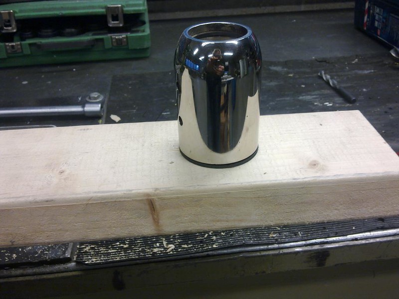

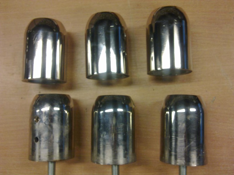

One of the boy’s in my business did a nice job today,
He has been polishing all 51 pcs SS side rail sockets
Here are a few of them, spot the polished ones
to be able to sand the gunwale capping thoroughly, we disassembled the complete rail attachement,
Inclusive the big brass screw with a big thread.
so that the capping was just bare wood without obstructions, (see previous report)
All the inner parts were plastered with many layers of silicone and all sorts of fillers,
but none of them was good enough to avoid water ingress along these fittings, inside in the gunwale (= a known problem on this boat model)

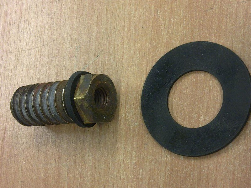

For a more future save mounting method, and avoiding this water ingress, I had some rubber washers made to measure
Here is the cleaned and polished brass screw with a new 3mm rubber washer

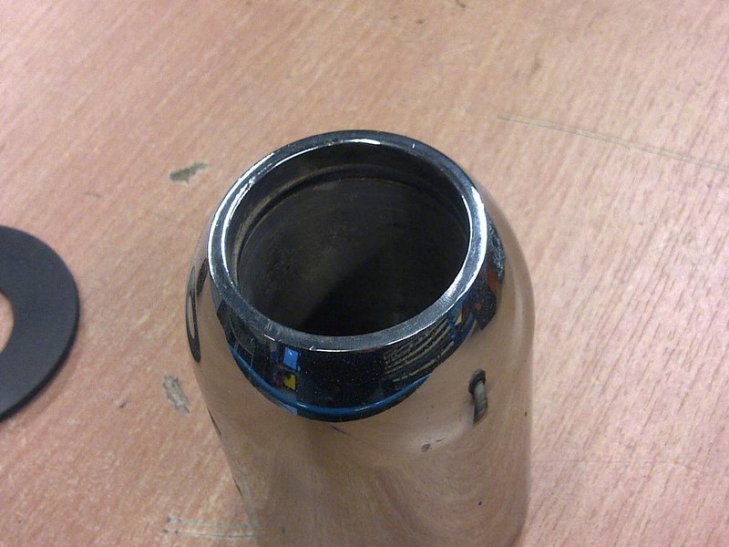

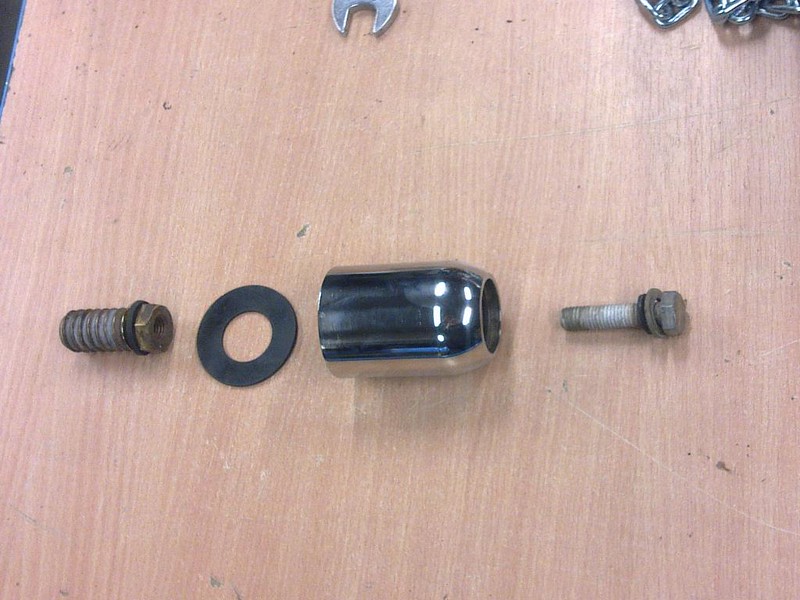

These are all the parts in one pic,
a big washer between the wood and the socket, and again a rubber washer between the M10 fixing screw and the socket
Spot the O-ring in the socket (this is orriginal)

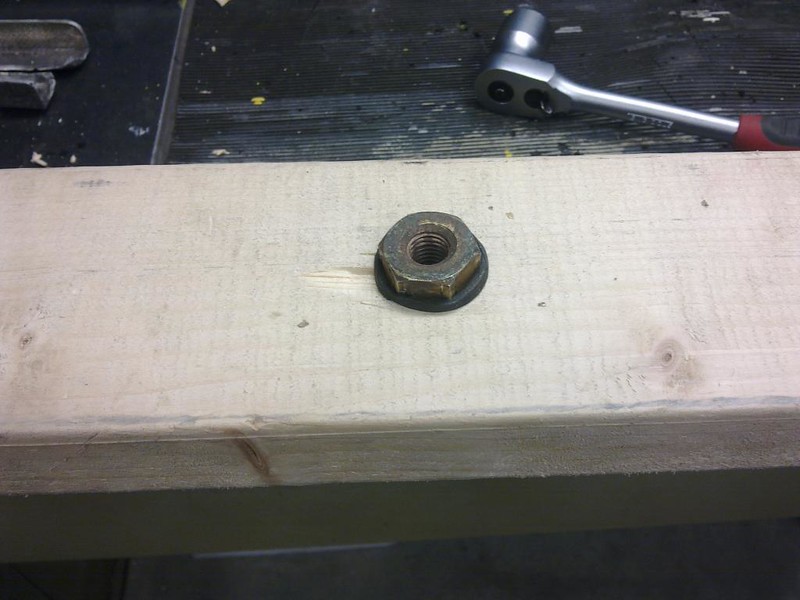

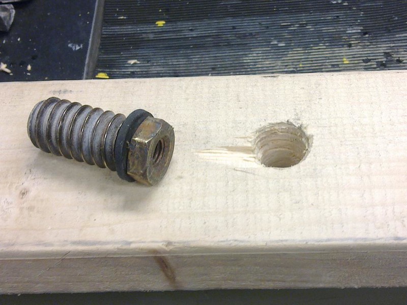

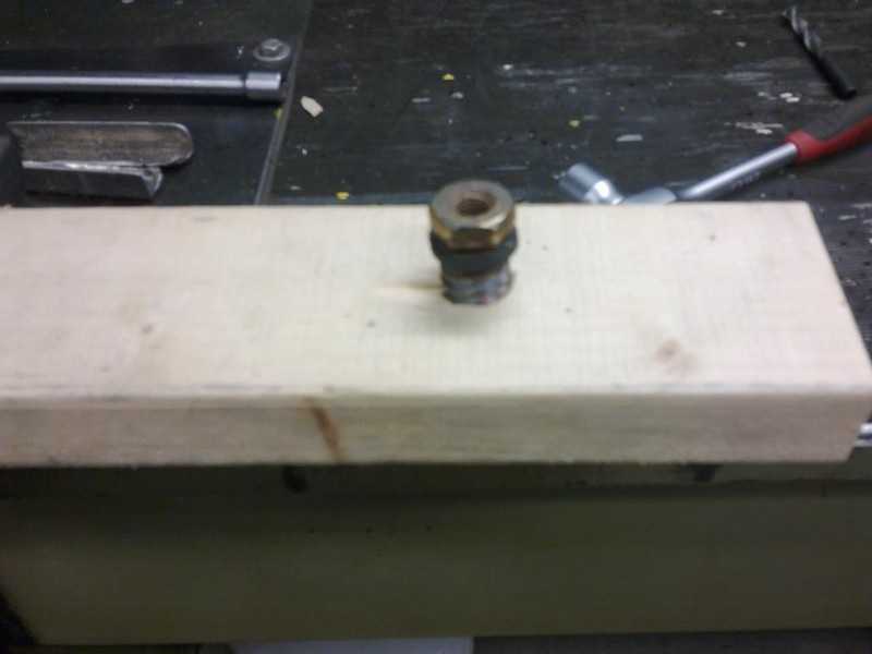

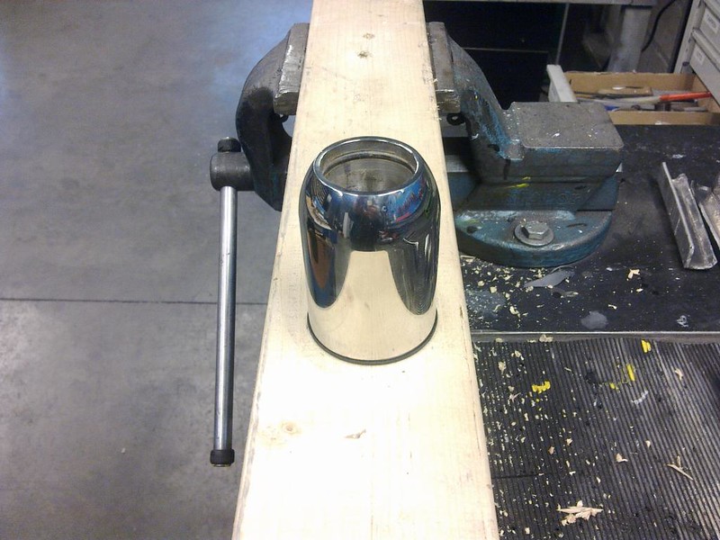

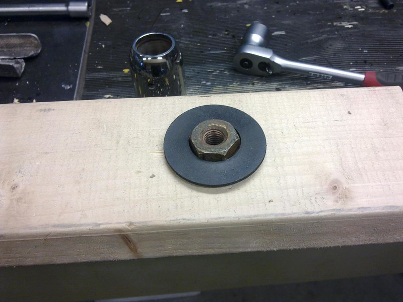

Now the mounting procedure,
The brass screw and the hole in the capping
Half way in
Completely in, the washer can fill the rough edge of the wood,
Now placing the big washer
The socket on top
And tighten the inner fixing screw, the big washer is extruding a bit from under the socket
Next week I’m going to fit them again on the boat.
