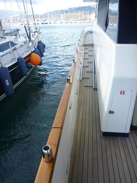

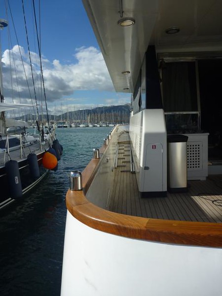

Bart, the detail with this bronze thick screw in your teak (and all the other bits that go with it) is really weak.
Vas, we were lucky, despite the old mounting method, and lots of crab and old sicaflex under the stanchions,
no damage on the visable parts of the teak capping
Here some pics from a few moths back now,
just before remounting the gardrails,
showing the freshly oiled teak,
and all bits nicely fitted together with rubber sealings inbetween (see previous picturepost)
each stud sits with a small black rubber ring on the teac

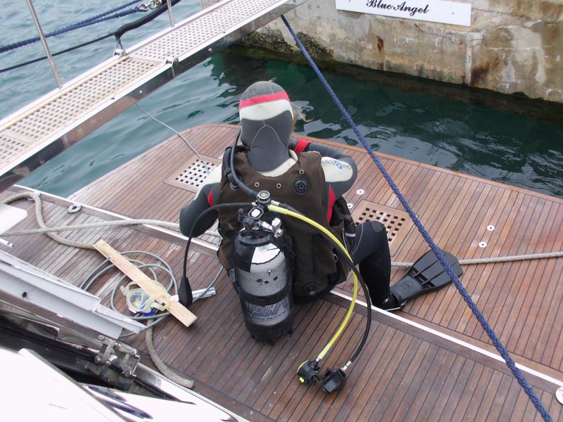

One more dive by the owner for final details on the stabilizer drawings

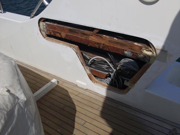

Acces covers to cables and fixing screws on the inside of the radar arch have been neglected in the past,

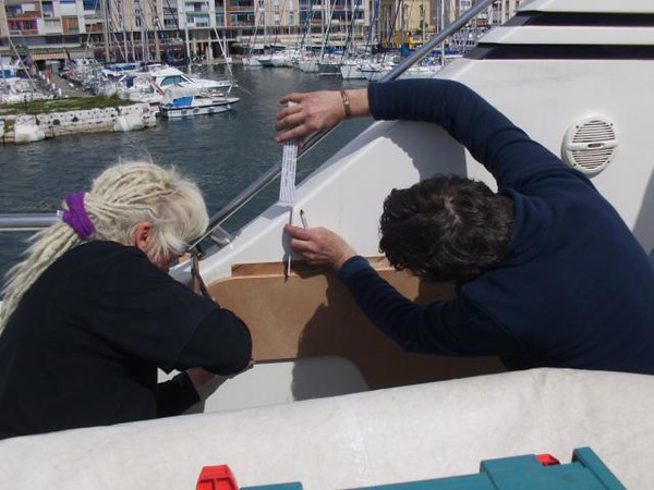

Result some rotten plywood in that area (no pics from before)
With a router we made one new large opening , incorporating all the old smaller openings
Here you see them checking the new lid:
No pic from the end stage eiter, but looked good and water sealed

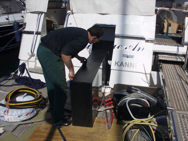

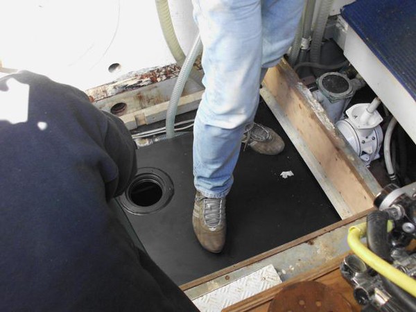

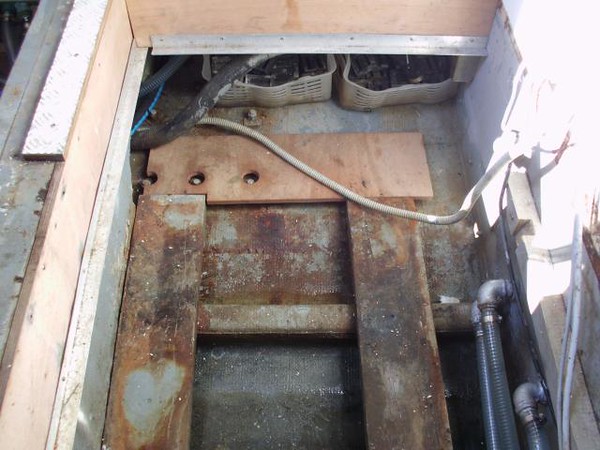

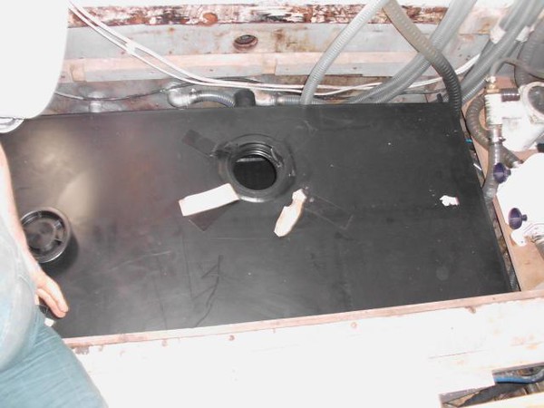

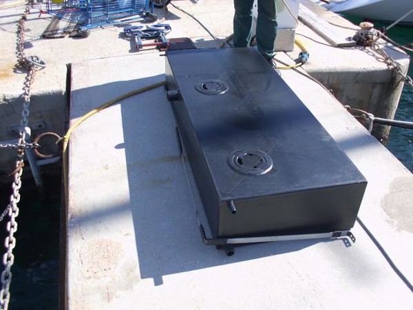

Our new blackwater tank has arrived:
The SS bar is for fixing against a frame

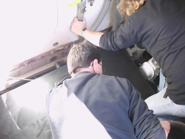

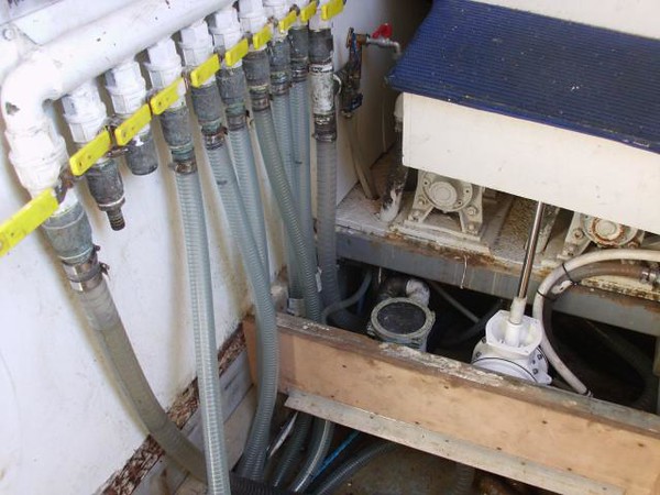

First replacing the old hoses and painting some tubes
And fit a manual bilge pump, (for the coding)
This is the spot where the tank has be fitted
Getting in was tight

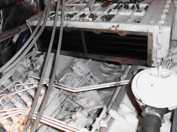

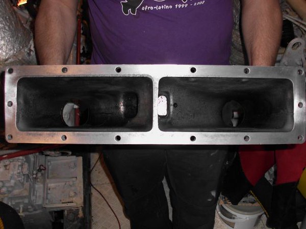

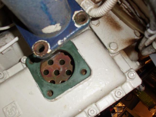

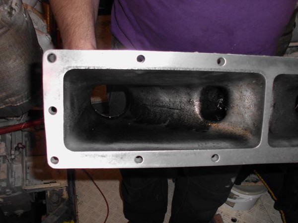

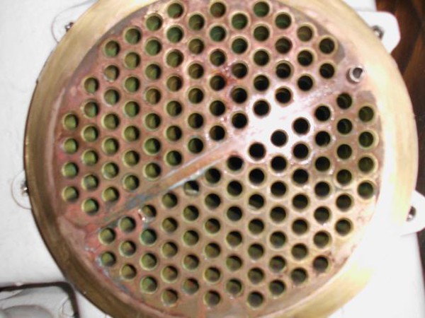

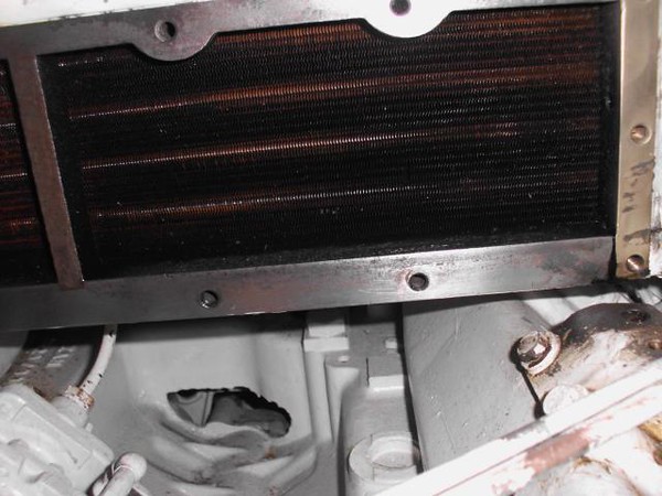

Following advice from MAN we opened the intercooler and heat exchanger for inspection and potential cleaning,
But this was all very clean

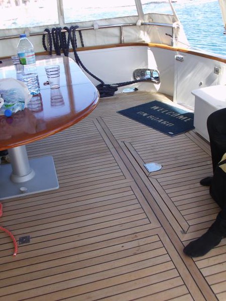

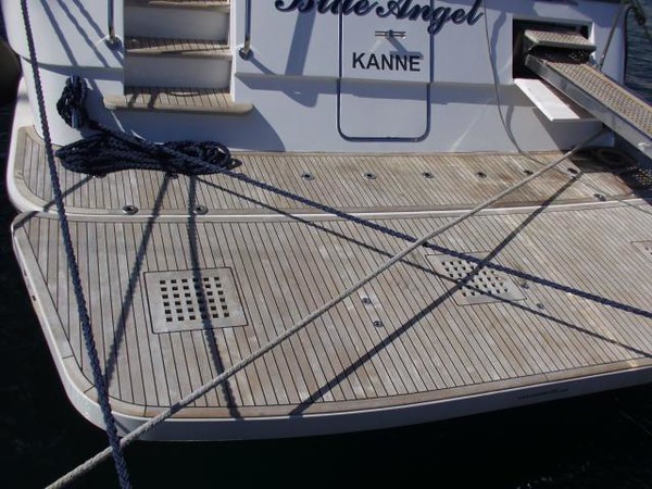

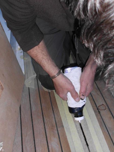

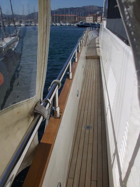

One friend sat on her knees during 2 day’s, she was in charge of the teak polishing (2 part cleaning)
and another did a few repairs on the teak Caulking

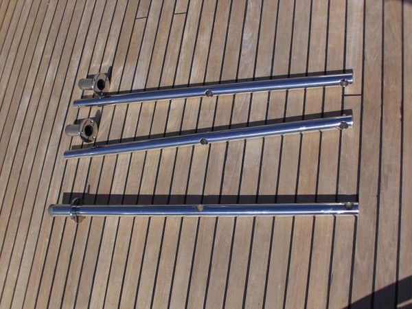

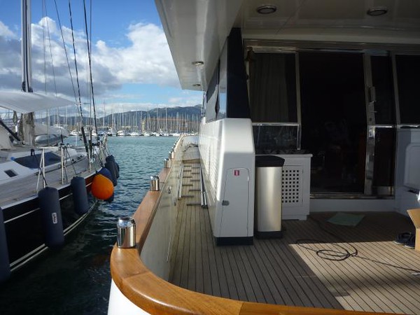

One friend had to leave a few day’s earlier, so I was personally in charge of fitting these removable scuba tank rails,
Distance between any 2 fittings is 40cm, so these can be placed in whatever configuration.
They are good for small (12l) aswell as larger (15l) and (2x10l) air tanks.

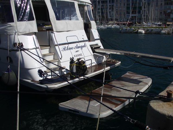

The divers can sit in front (while standing on the lowered platform,
And a assistant can walk between the transom and the rails.
The tender can still be placed on the hi lo part, (remove able tender supports) while tanks are in position
Yes I’m also a fan of the Straw brown natural looking teak, more pics on that will follow
Apparently not many onboard share that obsession;

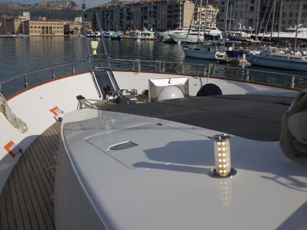

These tubes are for the new rear FB railing, new ropes still to be purchased, but here is a first impression.

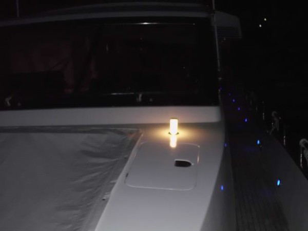

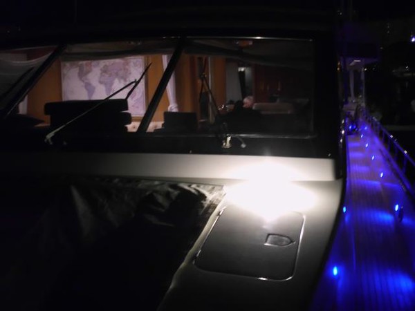

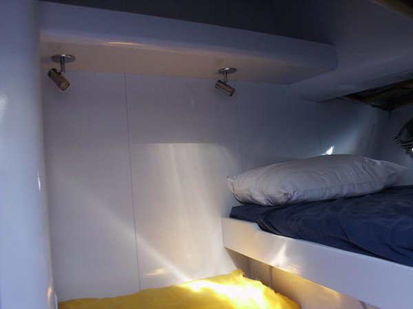

Did a big order for quick marine lights, and was seduced to order a pair of these “secret light’s” for a cozy atmosphere on the bow bed.

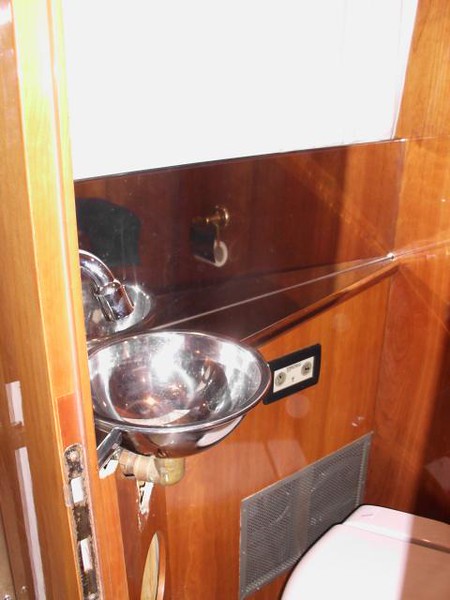

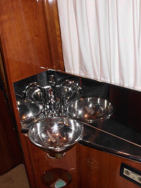

I’ve always’s hated that ugly brass sink in the day heads, but now nicely replaced with a shiny polished SS lavabo, also protecting the wals and the curten for water splashing.
In real it looks less shiny then on these pics
that wood panel underneath will be replaced / made new to measure

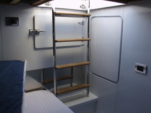

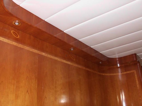

The biggest works have been done in the crew cabin,

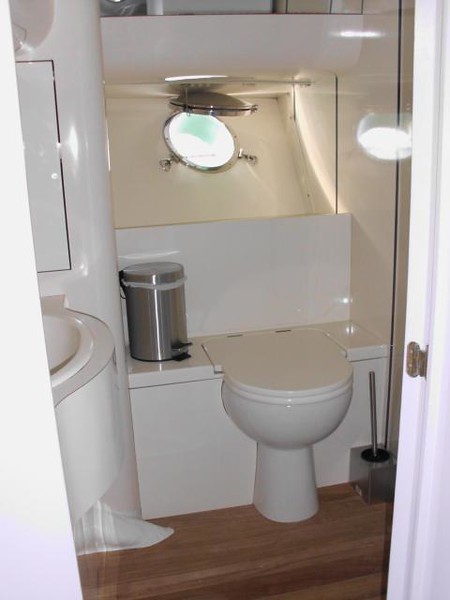

Rebuild a big part of the bathroom; sidewall, toilet frame, teak floor, cupboard doors, ceiling panels,
A combination of original formica, and newly painted marine ply in the same color
And cleaning, upgrading and painting the room itself

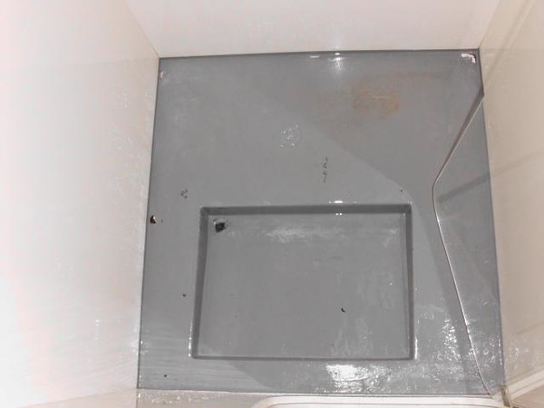

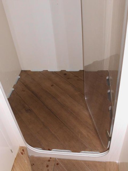

There were small leaks in the master cabin shower,
the seams between the Formica walls and the GRP floor sink, was leaking, shower water in the bilge.
We have protected these seams, the floor and 5cm up the wall, with sort of a rubber seal, that remains flexible (the grey stuff)
(got the product from a company who builds container houses, they use this for the shower)
and this is how it looks like with the original teak / ply floorplate fitted

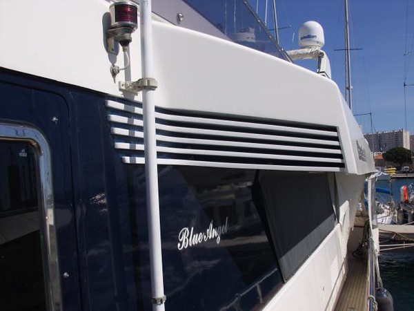

Parts of these decorative louvers were very badly rotten, so totally replaced on both sides by my friend carpenter ,
(with help from the famous painter ofcourse)

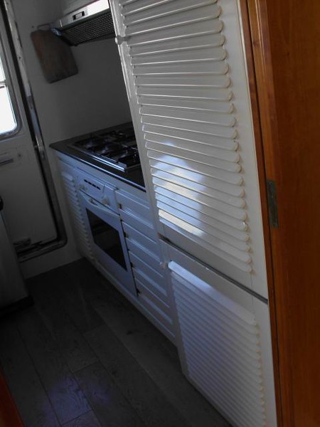

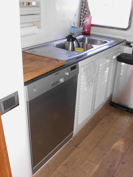

Oh yes, actually the first job we did was replacing the broken dish washer with a brand new Siemens with SS front.
The old one was smaller, but with a adaptation of the available space, the new one fits nicely.
Also the old one had a (ugly) slatted door in front, just like the fridge and the freezer here on this pic,
and these are on the list for next year, (with SS front)
as well as our old gas oven,
to be replaced with a SS front electric combi oven.

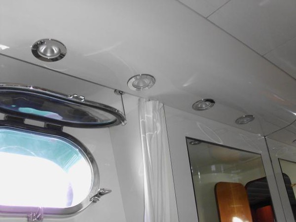

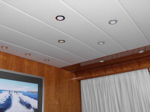

Allmost all lights are now replaced with LED, not only for the current draw, but mostly because of my banning of brass items on board.
I’m pleased with the quality of the Quick marine lights.
Apparently I’m the only one who notices that the CRI of these lights is not yet 100%, (but close though  )

black water tank looks small (for BA I mean, how large is it??)
name of the grey paint/material you covered the shower tray plz!

Hi Bart, nice job. That crew cabin looks completely new.
thanks Eric,
the color in the pics don't do justice,
the bathroom is a very light beige, same as all bathrooms in BA, and just on the edge for me liking ( I hate beige and yellow as you might know )
the color from new and old panels match very close, hard to distinguish the difference if you don't know it.
the painting of the crew cabin is light grey, with a very small blue-ish teint, less blue then in the pics,
same color as the new fabric for the ceiling, which is going to be used for all ceilings, everywhere in the boat, (except galley and heads)

random Qs
cheers
V.
original tank was a bit bigger, 400l
the new one is longer but less high,
1.75 x 0.7 x 0.3
we have a habit of emptying the tank each time when leaving a port / anchorage,
but in winter, when we don't go out much, I have to admid that most of the toilets flush direct in the sea.
don't know the name of the grey rubber,
will note the details when I'm at the boat in a few weeks.
still some of it left in the 5l tin.

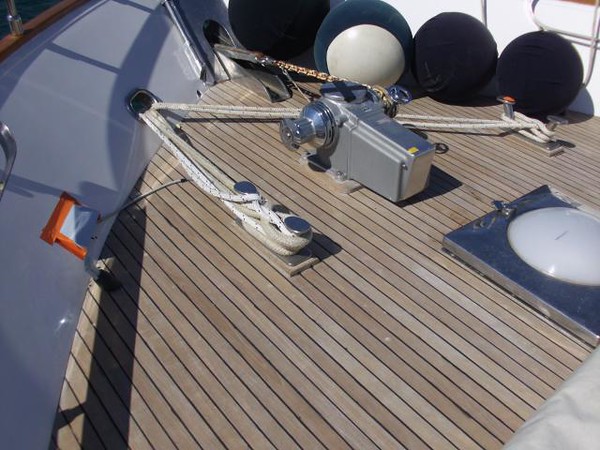

How you can manage to organize and actually fulfill maintenance activities which most boaters would ask a yard to handle, and keep your business running at the same time, that's beyond my understanding. Did you find a trick to make days last longer than 24h? :D
I see some tape on top of the anchor winch, does that mean that you're waiting for the Lofran's parts for the upgrade?
