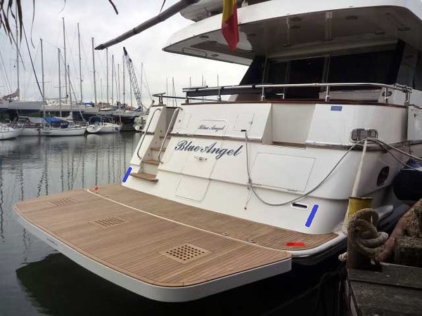

As an aside, I've seen what you said in the other thread on additional stern cleats for the spring lines.
Actually, my first choice (in terms of practicality of use) would be on the corners of the fixed platform, rather than under the fairleads - see the red spots in the pic below.
yes agree, was also my first choice,
but don't you think that the transom corner, just aside that SS slot will be stronger ?
on that position they would not protrude too much,
what do you think ?
thanks for the link,
was planning to fit 4 foldable cleats on the Hi lo platform, rear edge,
for mooring the tender, (between dives...etc)
or for fixing some fenders (horizontally)
Yes, probably on the transom you could install some bigger and stronger cleats, which could also be used for main lines. But what's the point?
Your existing internal cleats and their winches are very convenient, I can't think of a reason for not using them for the main stern lines.
Besides, you couldn't install cleats along the almost vertical stern in a way that the load would work along the proper direction, whilst on the fixed platform that is feasible.
Re. small cleats on the H/L platform for the RIB, they definitely make sense.
Not sure about 4, though. A couple of them would probably be good enough in most occasions.
After all, there is also some hazard involved with them, when they're raised: it's easy to guess that the platform will be a very popular place in summertime, with everybody barefoot...
Besides, I'm not a fan (though that's just a personal view, TBH) of fenders along the platform to protect the boat when moored.
I've yet to see a good fender-based solution for protecting the boat from hitting the dock.
Mooring the boat far from the dock and with tight lines is the only effective solution, imho.
never intended to use them for the main lines,
but almost "alway's" for the spring lines, re interference with the passerelle
agree with you on the load direction,
but main reason to put them there, is they are "immediatly" available, and never causing hazard...
lets have some experience with the mods first,
acces via the new steps to the transomdoor (with laundry)
might make me decide to follow your sugestion.
I'm completely with you on this,
fenders on the platform, feels like a invitation to touch the quai every now and then, which is a absolute NO GO imho

For the spring cleats, I'd definitely go with the blue position, in the red position you will need a bigger first aid kit for all the broken toes!
If you had a choice, I'd have advised against that model of plotter on the flybridge, the tracker ball is a really bad design for external use, and even a slight bit of salt causes it to be jerky and unpleasant to use. I'm thinking of changing mine even though it's not broken. Also Furuno spares are a ridiculous price (almost €1,000 for a new glass!), but of course you already had the scanner and one plotter, so you had no real choice but to fit Furuno.
Anyway, great job, well done.
Amazing job Bart. Congratulations. You now have the best c70S on the planet. You have done a fantastic job in making all these mods look original factory, not "owner mods" which takes extra effort but is the mark of a proper boat geek :D. I hope you have loads of fun with the new toys this summer
FWIW I would put the spring cleats in the blue position too (ie on the transom) even though all these things involve small compromises. And if you expect to use the transom door underway I'd put removeable side rails on the platform and an "overhead handle" in the transom bench box space you have made for your head as you walk down thru the transom door, but these are tiny mods you can decide about later, no big deal
No big deal, he must have a huge one already.
Did you see where the winches are placed inside the cockpit?
It must have been a popular choice among IT builders, some decades ago: place the winches wherever appropriate for maneuvering, without bothering about the crew feet...
Been there, done that. :D
I suggested foldable cleats for the red position, anyway.
