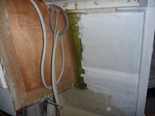

Here an update from the works, pictures from my visit last week;
The workers were sanding the gunwale, lots of dust, no pictures from that,
Here a few details from the finishing, they put a glass tissue on the wood, to make it more resistant for damage, and more resistant for moisture, they cover this with a layer of GRP , sanding and ready for final painting

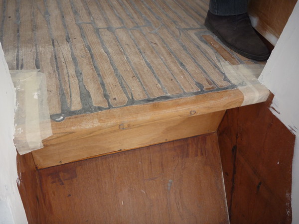

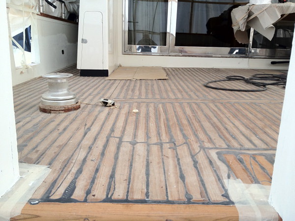

All deckfloor has been recaulked, sanding will be done really at the last moment, let the caulking stick and dry as long as possible.
Here you can see the edge of the upper step,
I have seen the other steps, these were finished, but not yet in position, but they look fantastic !

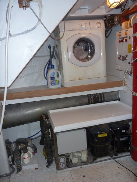

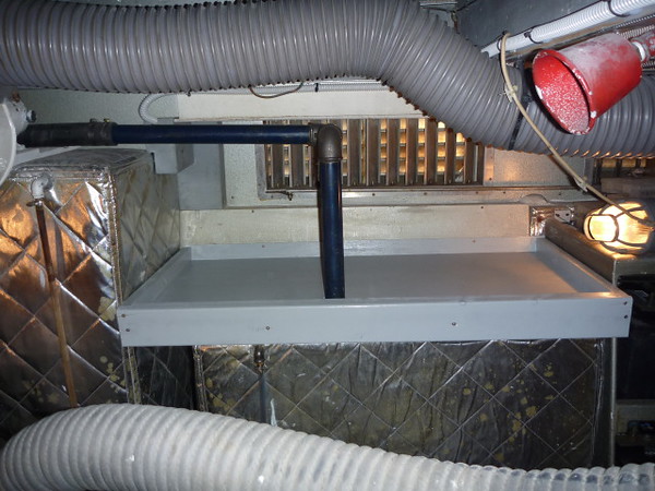

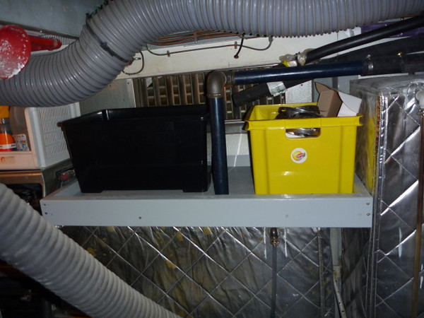

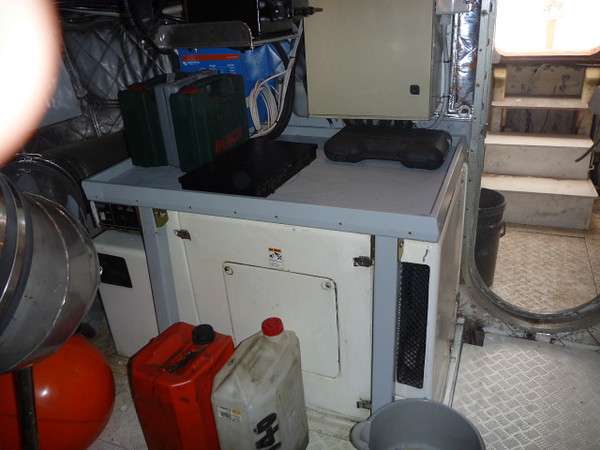

I had them make removeable tables above the generators, to be used as tools storage, work bench, and later for the scuba tank compressor (s) to sit on.
These shelves are made above the side fuel tanks, extra space for parts and stuff (used to be on the previous work bench in the util room, which is gone now.)

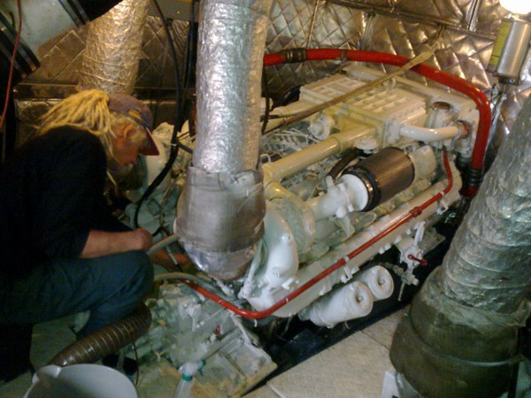

Look at that clean and shiny engine, and look who’s polishing

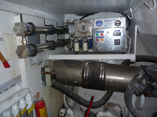

The desalinator in its new position in the util room, previously old fridge compressors were here

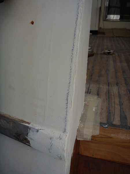

Interesting detail of the glass fibre fabric on the new construction, and on the internal wooden door frame
One more 90° turn , the washing machine in its new position. she could use some new paint aswell...

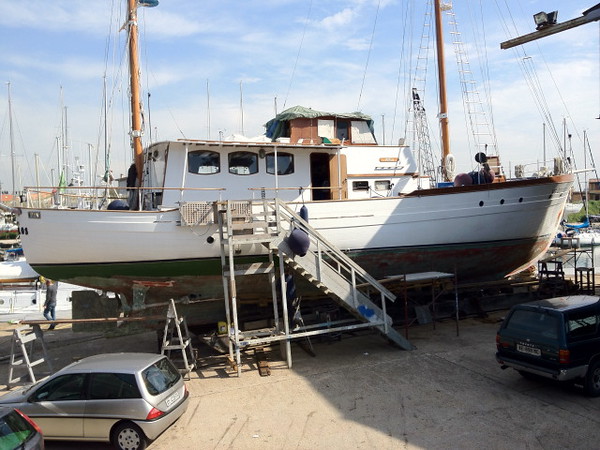

We visited the yard where we will do the liftout this year,
How come I like these nice old boats ?
BA will go out the old fashion way, on a sledge…
We choose that yard, as here we can do the work for installing the hilo platform,

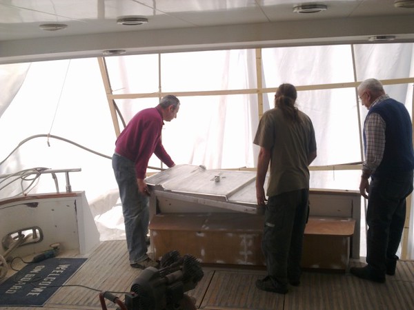

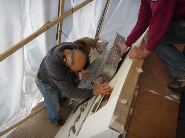

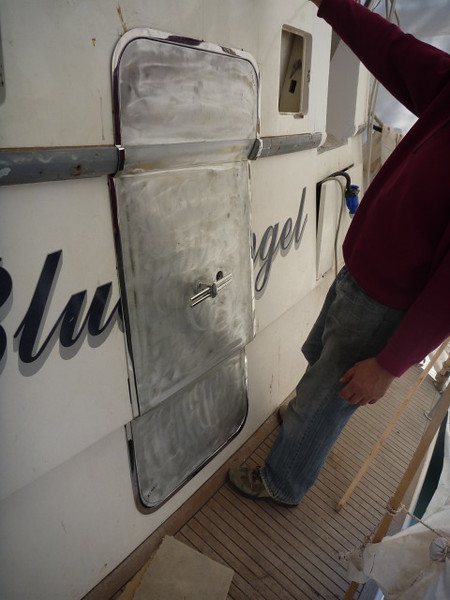

And now fitting the new transom door: (temporarily before she goes to the painters)
That’s a piece of art if you asc me
How does this work with the props sticking out so far?
I'd be really worried that the sledge's chocks were high enough to protect the shafts amd props.

You're right, Bart, that door is a work of art. Beautiful job. Ref the interior, green is a no no for most boaters as it is supposed to bring bad luck, agree brown is too much brown, blue is OK by me but best IMHO is the grey so I think you've done right
actually I don't really know, but I thrust that they know how to do it,
inside the yard was Canados 85, also on a sledge,
here this pic shows a C70 on a sledge (sorry for the quality)
they say, gettin her out takes one full day,
so I guess they do it carefully
