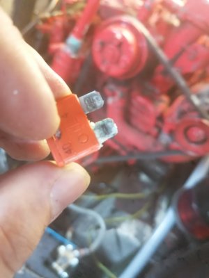

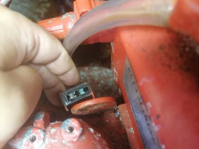

Okay, found the bastard. I checked continuitiy with my multimeter and there wasn't any from one spade to the other, so maybe a blown fuse and probably some issues between the keyswitch and the motor. I am off to halfords now to buy a new battery (this one doesn't hold charge any more.) and a new blade fuse. Fingers crossed it's just this now

Okay, got the new parts, but bit stumped on how I would go on cleaning the fuse holder now. I'd replace it, if I could reach the cable well enough to work on it, but I honestly can't.
And then that's maybe not even the solution, with my luck. *sigh* boat jobs...

Yes, moving the fuse is definitely useful for the future, but I only lack the access to move anything around, it's so inaccessible, that I can't even grab it with both hands at the same time, how am I going to do any cabling there?
Well, for now I have to wait for a very thin wire brush that I ordered, looks like a pipe cleaner but more resilient. Then just use contact cleaner spray and scrub it clean hopefully. If not I'll have to do it totally different. Fingers crossed it's just the fuse now
i guess the way to clean it would be something like a feeler gauge of approx thickness of the fuse blades with a bit of wet and dry glued to it, and just push it in and out, which could be done with one hand, even if with some difficulty, which lets face it, is just as awkward as removing and inserting the fuse itself.
