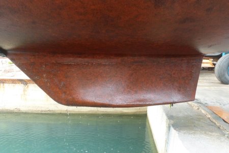

That’s an interesting approach on your boat. You can presumably scrub most of the hull from the deck, in the water, with the right brush if needed, but not the fin. And part of our rationale for copper coat was the application, or lack of it. We can afford a yard to do our boat once in 10 years, but every year would sting a bit. And though I have a few years advantage on you, I don’t enjoy being under our boat in the cold and dirt with any spillage dripping on me.
Your craft is totally different to mine. With 1.8 draft I can walk under it with my back bent ( or could before my injury)There is no spillage as such from a vertical fin although some dust from sanding. But it is only 3.5 M2 so not excessive
I still have it out on a full season for a mid season jet wash as coppercoat does not work. The shogun can be seen to perform considerably better, but I sometimes put another coat on then. It takes about 20-30 minutes to to the fin as I do not need to abrade it mid season. Just get the yard to jet wash that bit first so it starts to dry first. As soon as they are done, on goes the paint. Normally get the yard to do it just before the midday break so it comes out, is washed & I get some time to apply the paint before it goes back in.
Chiara’s slave
All sounds good. Our copper coat would grow a considerable beard if I didn’t keep at it, but I do that whilst OH and friends swim, or sometimes, best, in fact, in water a bit more than knee deep on a sandy beach. I doitonce a fortnight at least by peakgrowing season, ie now. Monday afternoon in Newtown was the most recent. If we used conventional antifoul, we’d just scrub it all off in 5 months, that’s what happens on the XOD. But then we crane her out and put her in a barn for the winter, and spray on a new coat in April. Not so much of an issue on a 20ft boat. Clearly the performance of both your antifoul types is very similar.
