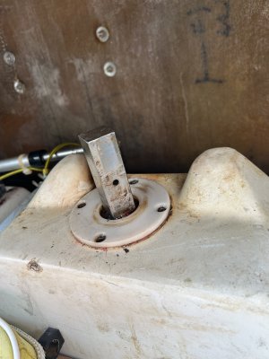

Hi Paul l have finally managed to remove the Vetus Rudder arm under which is a coller where 2 earth cable are attached do you know how that colley is held in place ?
Pleinmont
16 Aug 2019
292
I'm pretty sure there's an allen key grub screw or something similar that grips onto the rudder. Can't remember exactly but I took the rudder stock off a few years ago for painting and it came off quite easily. They get rusty from the deck fitting above that drips now and again.
I think a few people have had them remade in stainless once the rust gets too bad.
