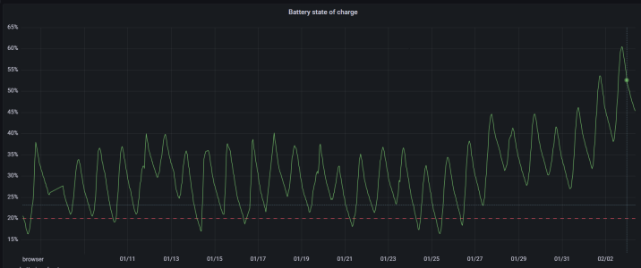

And cruising full time, LiFePo4 has completely changed my life ❤
This would be another dead set of batteries & no fridge due to low voltage. LiFePo4 just don't care.
