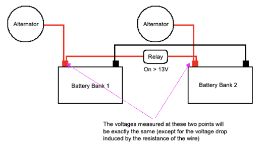

Agree. The only difference in voltage between the two battery terminals after they are connected in parallel will be caused by the resistance of the parallel wire itself.
The current that flows between the two batteries will of course also be limited by the internal resistance of the batteries themselves (which will be much greater on a lead acid).
Lithium batteries have a much lower internal resistance, which is why paralleling them requires much more thought.
Your original reply is in error ... because at the moment of paralleling - the batterys will still have their different voltge levels. As another says - the equalisation will commence once connected - but would need zero Ohm connection to be equal once equalisation has completed - which in actual fact is infinite time .... YES infinite ...
Its infinite because as the voltages approach each other - the net inbalance reduces and internal resistance of the batterys causes extension of time to balance. Only if you allow a practical range to be taken as equal - can it be finite.
Second as already explained - if a charge source is applied during the parallel connection - the charge source if sufficient will suppress any balancing of the two batterys and each will charge up .. as they charge up - their resistance to charge will cause them to approach each other in voltage etc.
Both scenarios are easily checked and confirmed if you have meters connected to each battery .......
Watch my video. That is not what will happen. Before you connect the batteries the batteries will have different voltages. After you connect them the voltages will be identical. After you disconnect them again the batteries will return to their original voltages (plus / minus whatever charge managed to transfer in the time the batteries were connected).
This is even more crazy. You cannot have two different voltages at the ends of the same bit of wire if no current is flowing down it!
V = I x R. If I is 0, V is also going to be 0. Therefore the voltage drop would be zero over the cable, and the voltage would be identical at either end.
In reality the current from the alternator will also mostly flow over the parallel link and into the less charge battery until both batteries are in balance.
So both alternators will be effectively connected to the same battery, which was the entire point of my original post.

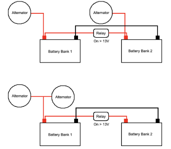

The original question was along the lines of “can I connect two alternators to one battery”
Someone posted something about the two alternators would interfere with each other as they would sense the voltage of the other.
Someone else then posted “you could connect each alternator to it’s own battery and then connect the batteries with a voltage sensitive relay”
I pointed out the ridiculousness of the above statement in my first post (20) as illustrated by the below diagram. Assuming the voltage is greater than 13V (which it will be if the alternator is running) you have wired them in exactly the same way.
We have then continued to have a slightly surreal conversation where you have continued to argue that the voltage measured on the battery terminals will be different even though they are connected in parallel with a bit of wire as shown below. But I think you have now slightly changed your position in your most recent post (if we ignore the bit about the 'valve' situation caused by the alternator which is nonsense).
For what it's worth, I don't actually know exactly what would happen if you connect two alternators in parallel. My gut feeling is that if they were similar models with similar regulators, they would actually share the load just fine and both contribute to charging the battery,
If they had different voltage set points, you would find that one would switch off before the other, but whilst the voltage was below the threshold, they would both contribute to charging (assuming the battery could accept all the charge current).

The point is, an alternator is not a 'dumb' DC voltage source like a battery, it is a machine which is attempting to control its output to achieve a set voltage. That's where it gets complicated.
The regulator in the alternator controls the field current in response to the voltage it sees.
There's a delay implicit in that.
So if the voltage is changing due to external causes (e.g. another alternator), the regulator may do the wrong thing.
That is the point the regulator on each alternator will see the voltage of the single battery and adjust the field current on each alternator to control the changing voltage of each alternator.
The field current on one alternator could be shut off but will not affect the second alternator
