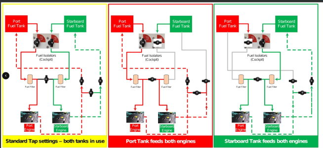

My boat has various valves that are normally set so each engine draws and returns fuel from its own tank . As said this is in the hope that a fuel issue is confined to one tank , which is in itself not a certainty if the source of the fuel issue came from the fuel supplier.
I have never found the need to alter the valves but they can be set so both engines use one tank. I don't think the balancing would occur under gravity since this is not an option in the instructions , although I have never tried it.
I compensate when refuelling for the often lower fuel level in the port tank caused by the use of the heater. The amount to add extra to the port tank is substantially via observation of the fuel level gauges and guesswork.

The set up that Momac has strikes me as being sensible as it keeps the tanks separate but enables both engines to run of one tank in the event that the other tank is contaminated. We can’t do that but then we can run on one engine and still go in a straight line due to being semi-displacement with a keel.
