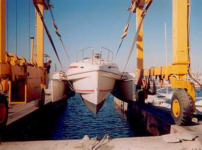

I'm not sure of the relevance of your comment. The hull shown is really an outrider and provides balance not displacement. Not even a University boat crew could keep it upright! Your central hull is exactly the opposite. It is an extremely flattened U and is probably about 4 times as wide as it is deep.

Float hull shape is vitally important to maximum performance of a trimaran. When sailing at the highest speeds typical small tris can achieve (about 20 knots for Dragonflies and Corsairs) the leeward float is providing significant displacement. At these speeds there is a tremendous downwards force on the leeward float, such that it is significantly submerged compared to static conditions. As the leeward float submerges, the main hull lifts. Even though the main hull should stay at least partially in the water for safety, at this limit of performance the proportion of the main hull in the water is significantly reduced. At the highest speeds, the leeward float is doing the displacing, the main hull is almost skimming. Float shape is important!
This looks more like a V shape to me...
