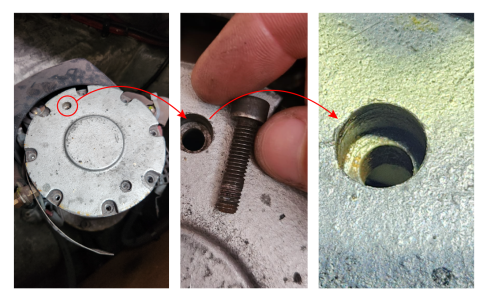

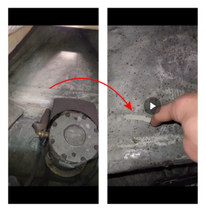

I was checking the bow thruster and noticed that it was covered with a black dust all around it (picture below).
So I tried to release the cap to investigate it.
I managed to release all the bolts but the cap didn't move 1mm to open.
Looks like it's glued.. (?) Is it supposed to open?

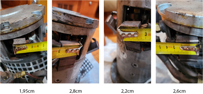

So I gave up on opening it and removed all the motor to check it.
And I realized that 2 brushes are smaller than the other 2. Maybe that's why it was realezing so much dust...
The opposites brushes are smaller.
Question 1) Any thoughts about why they are smaller than the other 2?

I suspect that is because when I was trying to release the cap (in the picture above) I removed that screw (in the picture above).
Now it doesn't screw in again... (it no longer has threads). I think that something that was tying it inside now is not there anymore.
But I can't investigate it properly because the cap doesn't go off.
