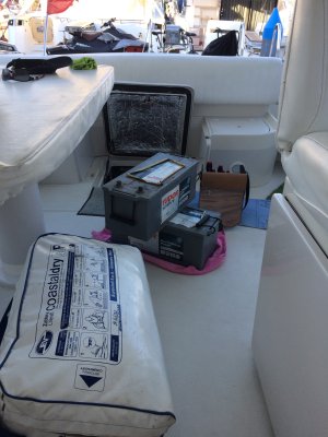

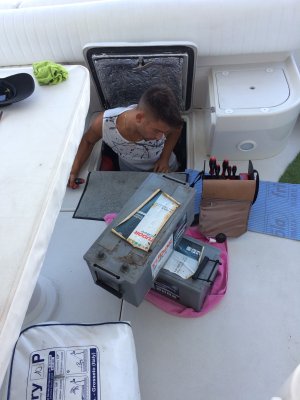

Just as said had a guys change over while I sipped Rose . Chicken feed in the gen scheme of running the boat .IMG_1327.jpegIMG_1326.jpeg
No lifting , no humping , no disposal .

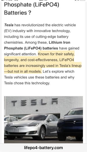

Yeh they are now days

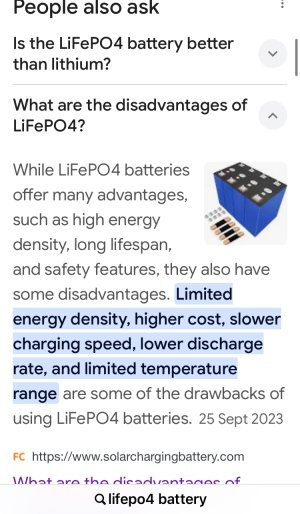

Here s what google says about the charge rates and power density- might be useful for 10 L v8 diesel starting batts :?or Not !
View attachment 197557View attachment 197557
View attachment 197558View attachment 197558
314Ah of LifePO4 takes up the same space as a single 110Ah LA battery nad weighs less.
It can be charges at .5C, that's 157A, from 10% SOC to almost 100% SOC, try that with LA.
Life PO4 are now cheaper than LA.
Googling out of date articles further illustrates your lack of knowledge and understanding of the subject matter.
