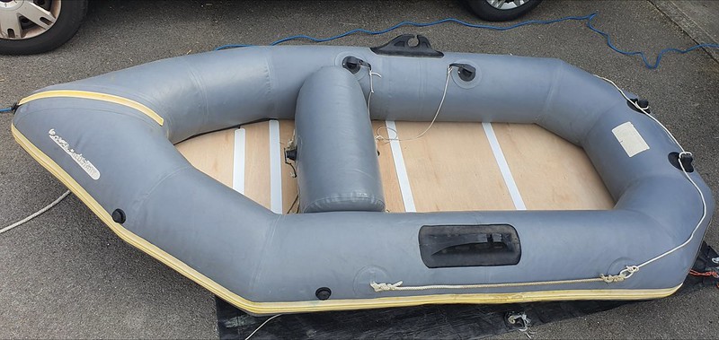

I still have the inflatable though, and a smaller Redstart. I wanted a dinghy for fun at the beach last year, and picked the Redstart as it takes up least room in the car. I bought a couple of sheets of 6mm 'marine ply' from B&Q, cut them to size and epoxied them fairly thoroughly. Photo from before I coated the boards. I used H-section plastic strips to join the boards, as recommended here.
I mixed black and white 'Fortress' all-surface paint (very tough stuff, recommended) into the exact same shade as the classic Avon grey. Two coats made a thorough covering, plus I knew that if I could ever see any unpainted wood, that area would be subject to chafe.
I knew DIY-store grade of marine ply was a gamble which risked wasting the epoxy and paint and all the time spent measuring, cutting, sanding and painting. I have to say the ply hasn't failed yet, nor did its thinness make me worry. I suppose if, without boards, loading the unprotected rubber doesn't actually deform more than a few square inches of the floor, then pressing substantial localised weight on 6mm ply which is itself supported by the rugged yet flexible bottom, doesn't subject the wood to breaking forces.
Late in the summer I met a mate who used 18mm or possibly 20mm ply for his Redcrest floorboards. They looked tough enough to load up with commandos and their kit, but they also represent a significant bulk and weight burden...
...so, to the many contributors to this thread who simply don't use or own floorboards for their Avons, I can say that having made my own for the Redstart, I will gladly repeat the effort for my Redcrest this year because it's so much better than the soggy rubber floor of these old-fashioned tenders. Thin, light ply is strong enough if treated, and isn't a monstrous bulk to carry or stow.

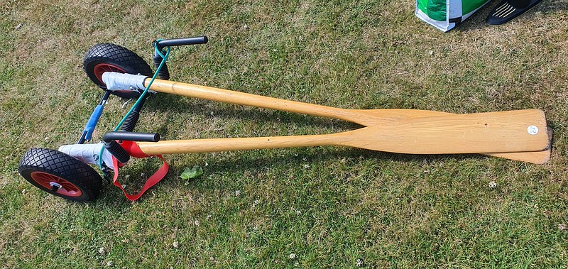

Knowing I'd have to carry the dinghy, floorboards, pump, oars, anchor and substantial picnic from the carpark to the beach, I decided to make a trolley. I found a Conwy kayak scupper trolley (that's a link to my review), clearly designed for kayaks but quite easily adapted, using the oars as handles and the floorboards to make a platform for the other kit. A real success...sadly no better photos.
