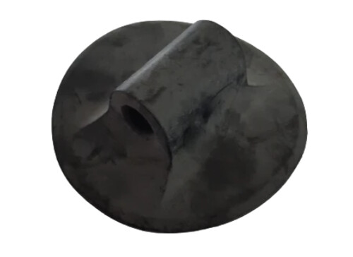

I'm looking for an additional pair of the heavy black rubber lugs which belong on the outer underside of the Redstart's tubes, in which the engine bracket fits securely.
I had begun to suppose I wouldn't ever find a set of these, unless I bought another whole elderly Avon. But forumite Ribtecer discovered what certainly appears to be the item, at The Chandlery Barge...
...unfortunately the Chandlery Barge charges £16 per socket, so for a pair it might be far cheaper to buy a written-off Avon, except I don't think the boats are ever discarded. I enquired of a West Country boat-breaker, and was told they rarely see Avons.

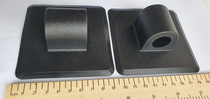

Well, my Chinese-made engine-bracket lugs arrived. They're not as rubbery as the originals aboard the Avon, but I don't know if that matters.
