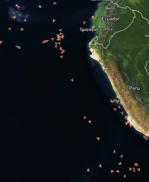

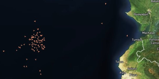

The seals may not be fat for much longer. Those waters have been overfished for decades, it will be as dead as the Atacama before too long.
You can see the mainly chinese fishing boats in the two attached screenshots, second one is zoomed in to the waters off the Peru/Ecuador border to show the actual numbers. Fishing the living daylights out of it just outside the 200 mile limit.
And don't get me started on the rape of the South Pacific mackerel fishery. It takes 4kg of fishmeal made from mackerel to produce 1kg of farmed salmon.peru1.jpg
