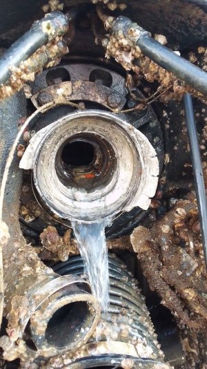

Haha. It was the other end of me that got wet, changing props on an old 290 years ago.
Had outdrives from 1
I've had out-drives since I was about 19 (few years ago now). I have honestly never had a days bother with any of them. The only nuisance is a bit of maintenance, but hey, it's maintenance... nothing has actually gone really 'wrong'.
I did have an actuator fail a few years back, but that's not really the outdrives fault.
I ran DPS outdrives with 5.7 litre V8s for 14 years. I did my own maintenance.
The first, a second hand boat, for 3 years. Oil change every year, anodes every year, no other costs apart from O rings for the drain plug and a one routine bellows replacement
The second, new, exactly the same. I did ( easily) change the shift cable after 7 years ( about £35 at the time). I had to realign the engine to make the outdrive easy to refit as the factory did not do it properly in the first place ( they were laying off many workers at the time, so morale/ motivation was low).
Never a failure.
